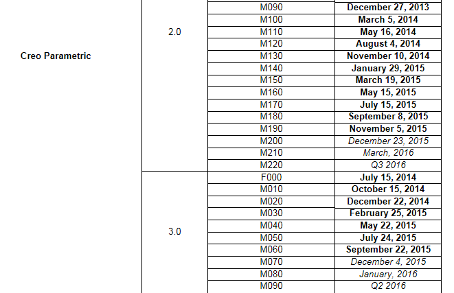

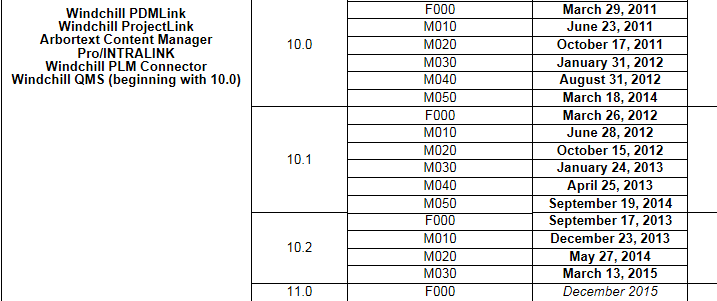

So when is the release date for Windchill 11.0? PTC's Calendar says "December", it is December.
18-Opal
December 3, 2015
Technically, I guess they have until the 31st at midnight...
December 3, 2015
Looking at the Product Calendar, Creo Parametric has an actual date assigned for future releases.
Windchill 11 only has the month and year.
Could PTC delay it? Yes
We have already been over 2 years since 10.2 was initially released.
We pay annual maintenance for what????
