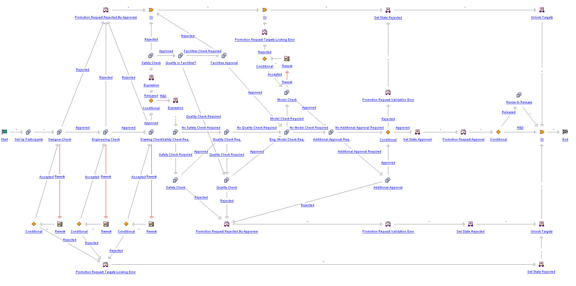

I am trying to create a custom workflow in Windchill 9.1. I want to have a decision made that will cause the workflow to travel one path or the other for a few items, merge back together for the next few items, then split for the last item based on the earlier decision. I think I can do it with Execute Expression Robots and variables. Any one out there able to help with the scripting, or perhaps suggest a better way.
Currently I use two consecutive workflows, but much of the information requested in the first, is also requested in the second. This means the initiator not only has to initiate two workflows, but also re-enter information that was previously entered in the first workflow. Being able to start one workflow, have the user choose a path and later use that same choice to determine the direction to take on the next fork, would greatly help ease user adoption to the system we've just begun to use.

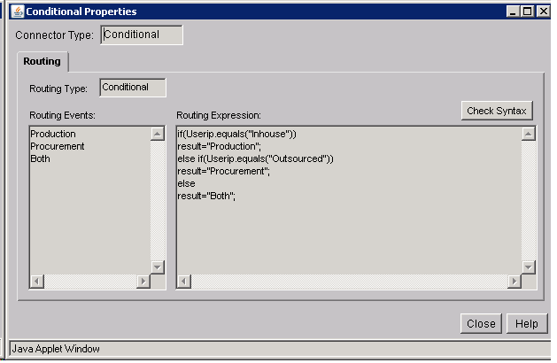

1) Create a variable in the workflow of type boolean.
2) Write your question name in the display name of that variable.
3) Add this variable to the activity you want, where it will be answered.(Will be ticked if yes)
4) Now the answer i.e. Yes or No will be saved in the boolean variable.
5) When you want to use it for further routing you can put a conditional block-
Select the Routing type- Conditional.
The Code is-
if(Userip.equals("Inhouse"))
result="Production";
else if(Userip.equals("Outsourced"))
result="Procurement";
else
result="Both";
6) Here Userip is my variable Name.
And the options provided in result should be provided in Roting Events.

ShawnPete1-VisitorAuthor
January 9, 2013
Thank you all for all your help. If anyone is interested I can post the results. I was able to creat a singlr workflow to handle all my promotions.

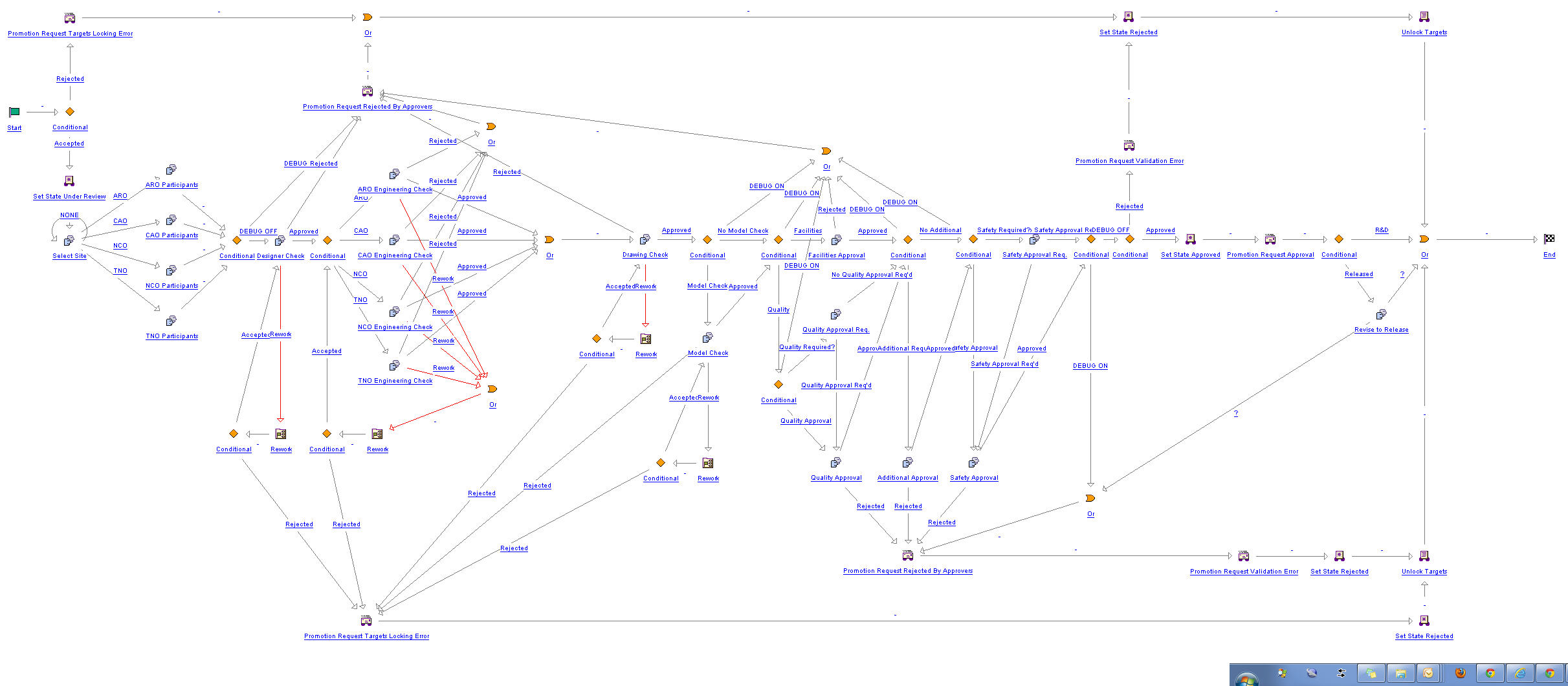

January 14, 2013
The following image is the resulting workflow. The resultant ZIP is posted to allow others to view the coding.
