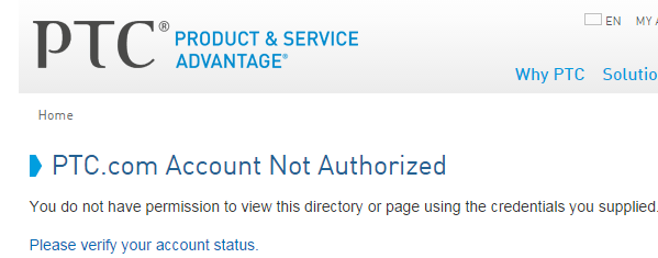

I tried clicking on your hyperlink and got...
The files I am talking about are some Robotalk mp4 files, and even a preview is not required or streaming as it might consume enormous bandwidth, if everyone hit Windchill concurrently during the 6 weeks of FRC. Feel free if you get sometime to look around in our Windchill account as you are included as a manager. I guess I am at a stage where I know enough to be dangerous, so help keep me in the straight and narrow.
September 18, 2014
Hi Emil - the link probably did not work for you because of the "cs" in the path. That indicates to me that it requires a log in from a paid-maintenance account. I think CS = customer support; aka with maintenance contract.
