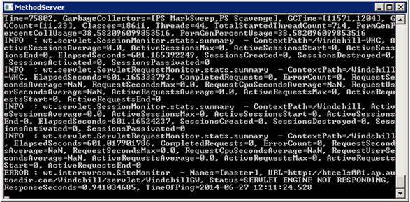

May I know which entry to be changed. Please find the attachement of the slave method server which shows servlet engine not responding.

The properties look correct to me. Were there any errors in the Slave's MS log during startup? Have you mapped the cluster alias to 127.0.0.1 on the slave node?
