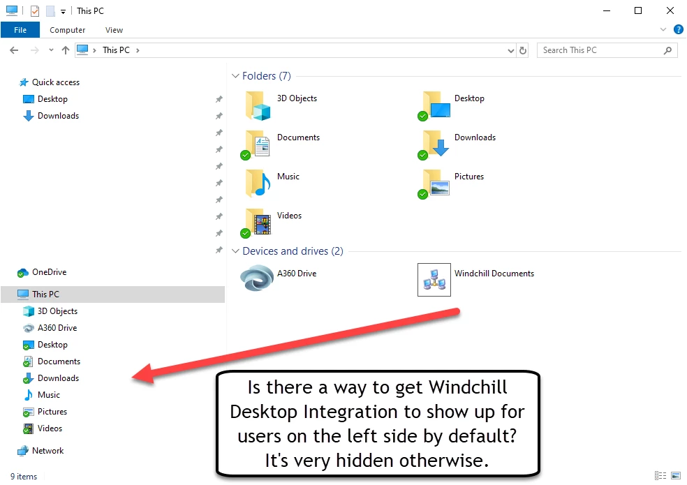

Trying out Windchill Desktop Integration (WDI) for the first time using Windchill 11.0 M030. Am I doing something wrong?
Thoughts:
  • I cannot get WDI to show up on the left side of Windows File Explorer like OneDrive or other similar apps. Is there a way to get it to show by default? WDI very hidden otherwise. See attached image.
  • WDI doesn't not show up as an app anywhere in Windows 10 - it's like a hidden install. Searching for Windchill returns no application in Windows.

Dec 4, 2019 1:12 PM UTC
According to the help documentation, Windchill should've shown up in my Windows Explorer favorites by default but it did not.
