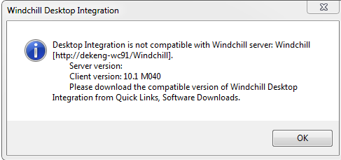

Hi All,
I've got a test 10.1M040 Windchill server set up and want to run DTI on my local machine (Win 7 64bit) Office 2010
I've set the preferences in Windchill and downloaded and run the installer from the server as directed in the DTI Guide. When I run MS Word or Excel Windchill tab appears correctly.
I then configure the connection to the server which asks me for Username and Password.
When I try to use "Select Active Server" it comes back with
The software was installed from the server so the version is correct. It looks as though it is not writing the values into the registry correctly.
If I repeat the same on another machine (64 bit) logged in as me it all seems to work correctly and there are differences in the registry entries
Anyone seen this and fixed it

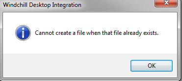

PS if I do change the registry so the server values are correct I get another error as follows: -
I got to Demo this to some interested sections of the business next week so am trying to get this fixed,

Chris, I'm not sure why one machine would work and the other would have an issue. It looks like you are working with TS under case 11589813. My suggestion would be the same. Uninstall any/all versions of DTI and then remove the key named Windows Integration from HKEY_CURRENT_USER\Software\PTC. Reboot. Reinstall.
Instead of configuring manually, try connecting via browser and then just click on an Office document icon to trigger a download. With the Windchill Attachments > Download Mechanism preference set to DTI, this will auto-configure your connection and download the document.
Is it possible this machine has a host entry for a different server with the same name? Seems odd that it cannot pull the server version, but understands it is not the right version.

OK so we've done quite a bit more digging on this issue and it seems to be the installer runs ok but using the configuration does not populate the registry properly.
After a fresh install the registry only has a few keys for windows integration, then once the configuration is run (In Word etc) the details of the server etc are then set in the registry, this is where we seem to run into the issue. We run Kaspersky disk encryption and AV on laptops so I think it is to do with this as on other dekstops still with the AV but no disk encryption we do not get the issue,
Can someone explain the process of what touches what during the configuration,

April 4, 2014
I had exactly the same error here, and it turned out that it was because in the Windchill Desktop Integration Configuration I named the server connection alias "PDMLink", and that name was already used in my hosts file.
As soon as I renamed the server alias everything worked fine.
