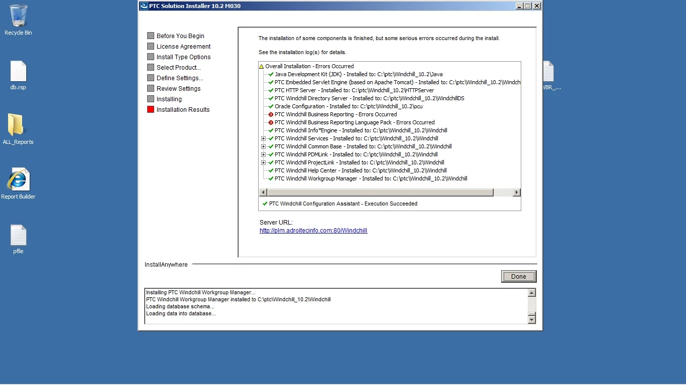

Hi All,
I've installed Windchill PDMLink 10.2 M030. The installation has been completed  but  with leaving two error at Business Reporting and Business reporting language pack.
Unable to find the reason for this.
Request you to suggest me  how to resolve.
(I'm here by attaching  error screen shot )
Thanks In Advance

This screenshot does not give enough information on why it is failing. You should be looking at Windchill_10.2\Reporting\installer\logs\WBR_Install.log and ptc\Windchill_10.2\PSI\installer\logs\PTCSOLNINSTALLER_PtcInstall for additional information.
I have noticed this error when you are trying to install Cognos from installers located in network folder.

I've searched for the above mentioned logs and found the below error.
Starting Cognos Failed: "CFG-ERR-0101 Unable to register IBM Cognos Service
I could not find any solution for this.
Kindly request you to help me on this issue.
Jun 11, 2015 8:45 PM UTC

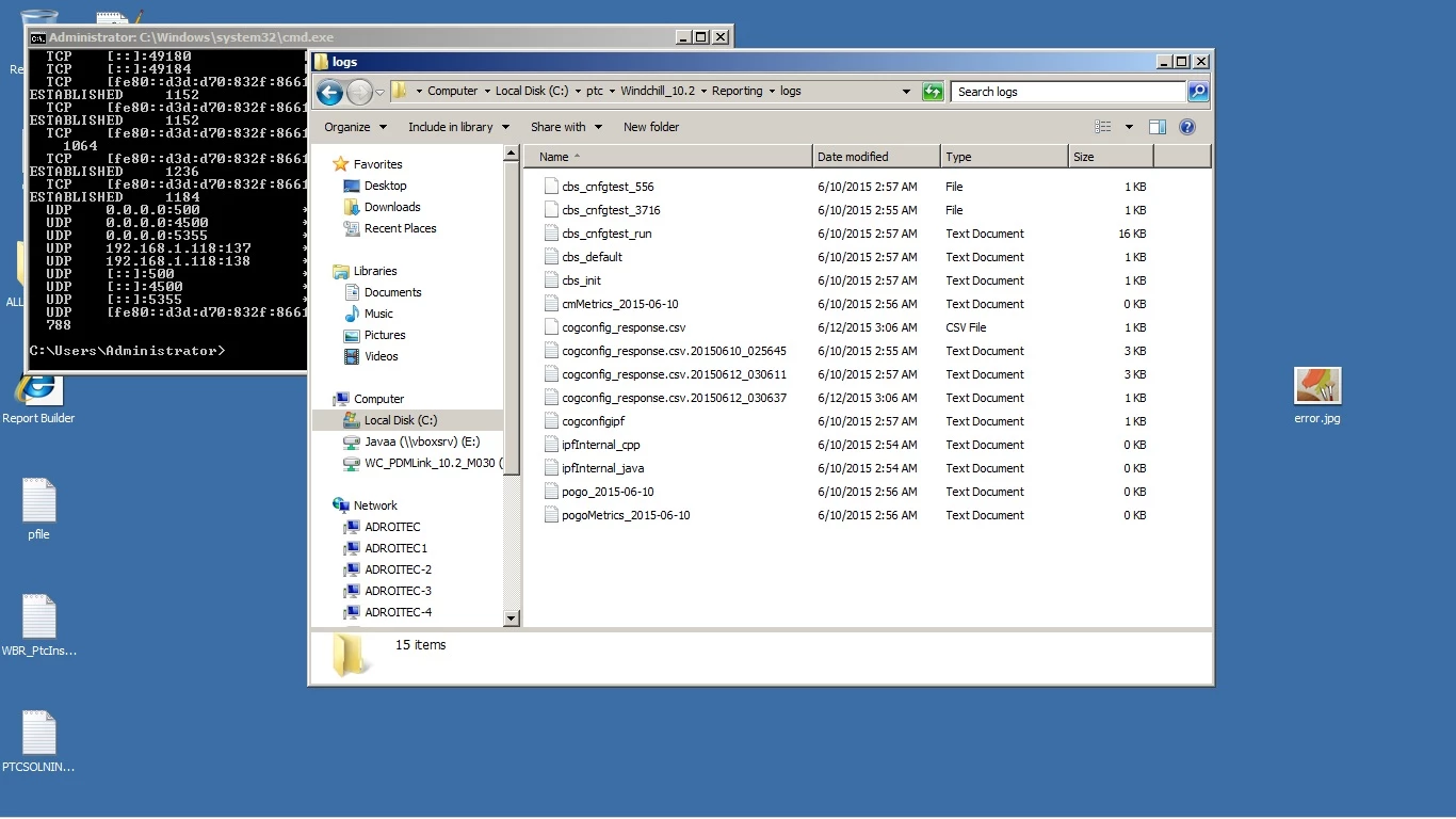

That message is saying that Cognos failed to start. You'll have to check the cogserver.log to see why. The cogserver.log is located in your <Reporting>/logs directory.

Hi Binesh,
I could not find cogserver.log which you've  mentioned in specified location. Please find attached screen shot of that location.
Also, I could not find any IBM Cognos related services from Windows services.
Jun 18, 2015 6:52 PM UTC
Try testing the cognos configuration and see if that reports any errors. Open the cognos configuration utility by running <Reporting>\bin64\cogconfig.bat. Once the utility has loaded, go to Action->Test. If that reports any problems, check the details to see what is failing.
Jun 12, 2015 6:07 AM UTC
HI Krishna,
As I have installed 10.2 M030 on 6 servers till now and every time I found this issue except one server.
As per me, this is a Bug. After cognos installation, it creates a windows service as cognos, but does not get started automatically during installation process and then installation shows as failed for both cognos and language pack.
I found a workaround for this issue.
when installation fails, start Cognos service from windows services-cognos-start. Confirm services started.
then again run the psi and this time select recover failed installation. Installation will be successful.

I could not find any Cognos services from Windows services
