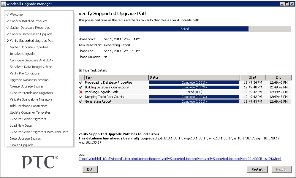

Hi Fellow Windchillers,
Am working on a test run of Windchill upgrade. Have run WinDU successfully and on executing the UpgradeManager and after entering the source database details am getting the error "Database has been already fully upgraded" (log attached). Please let me know how I can proceed with this test upgrade.
Am planning to upgrade from WNC 10.1 M030 to WNC 10.2 and planning to keep the same host for upgradation.
Amol

September 5, 2014
Addendum..
I can see from the html log that the source and target versions are the same. Please let me know how to specify a different target version.

September 5, 2014
From the looks of the screen shot and where the logs are being written, you
have run upgrade manager from the Windchill 10.1 shell. You need to run
upgrade manager from the Windchill 10.2 Shell.
That should resolve your issue.
