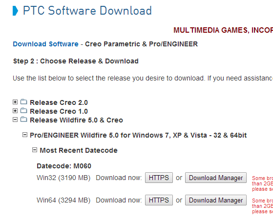

Since the update to Wildchill 10 we have been completely cripped because we can't pull anything off of our servers.
Has anyone else had this problem?
Using Wildfire 5.0
datacode m060
Windows 7
Ungraded to Java 6.
Changed default windows browser to Firefox (IE 10 is not supported)
Renamed .wf folder to r91.wf

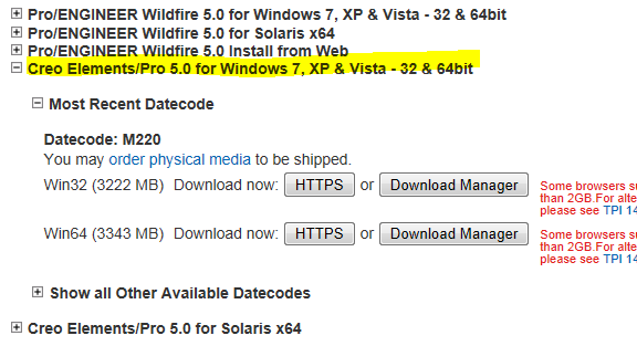

Best answer by TomU
There was a name change. Look under Creo Elements Pro

Better check the software matrix. I'm pretty sure WF5 M060 is NOT compatible with WC 10.1.

Hi Tom,
Thanks for jumping in. I think M060 is the latest Wildfire 5.0 Datecode available on the site...
do you know where I can get M130?
