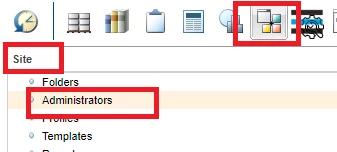

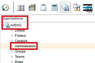

Normal user can not see that icons. org/site level. Only administrators can.
There is not difference between normal/enterprise version. All Windchill versions from 10 to now has this icons. Just appearing is based on an access. Org admin can see org level, Site admin can see site level.

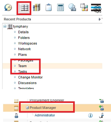

Product Manager can manage a teams and so on.

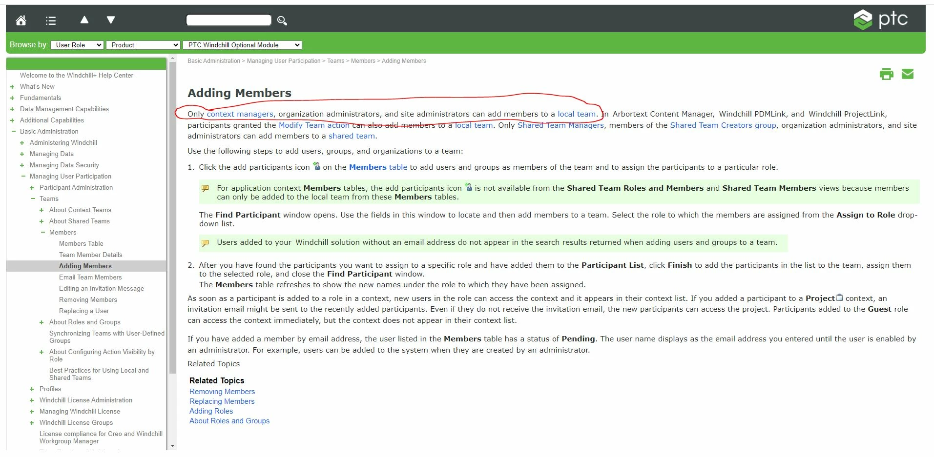

I looked into this subject within some Windchill support pages on the web, this one was of particular interest:
https://support.ptc.com/help/windchill/plus/r12.0.2.0/en/index.html#page/Windchill_Help_Center%2FTeamMembersAdd.html%23
If I understand this correctly, the reason that I don't see any tools to change or add team members is because I don't have any admin capability. (See attached jpeg capture, circled in red.)
I've forwarded this information to our site admins.
