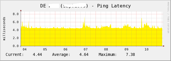

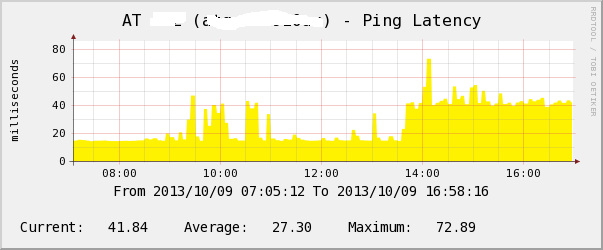

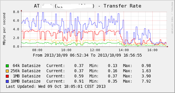

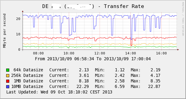

I don't think there is something wrong with your system. The performance depends on many things and there is no easy answer. Depending on network speed, network devices, file system performance, number of methodservers (parallelism), file size and other things your results may vary widely.
We are operating a system with eight Linux Clusternodes and fourteen remote FileServers all over the world. As for the reference value we are using wget as a simple way to simulate download from our master system. We use this to monitor network performance to our remote sites. All communication is https.
First a site near to the system:
Now a site with medium latency:
We also did some testing for best case values with wget of a 141 MB file between the CADWorkers and the MethodServers. This gave a reference value for huge files of 62 MB/s maximum for transfer within the LAN.
The next value was up to 34 MB/s for systems in the Intranet of the datacenter, now with Routers and Firewall involved.
These values may not reflect the actual performance for the PDMLink system but they are easy reproducable and may serve as a reference value for comparison.
