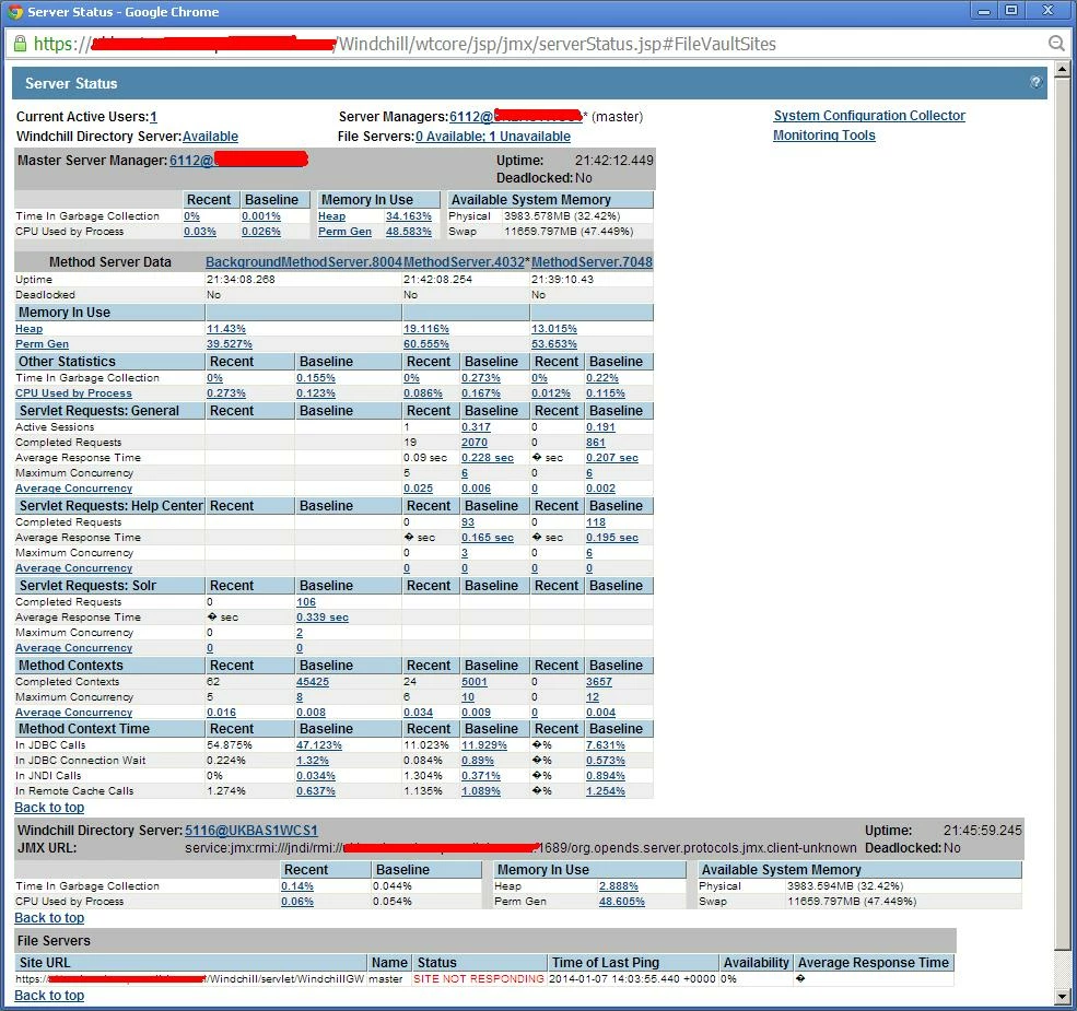

I've recently installed an monolithic instance of Windchill 10.1 M040 (SQL Server) and have spent several weeks tailoring it to our requirements, testing workflows & lifecycles document uploads, check ins & outs and so far everything's working well. However, I've just noticed that when I interogate the "Server Status" the report states the following;
File Servers: 0 available; 1 Unavailable
and the bottom of the report states;
https://<our winchill domain name>/Windchill/servlet/WindchillGWmasterSITE NOT RESPONDING2014-01-07 14:23:59.570 +00000%
I can ping the server without any issues.
Can anyone shed any light on what might be wrong?

The basic reason for this is really, really simple:
When the method server pings https://<our winchill domain name>/Windchill/servlet/WindchillGW/wt.httpgw.HTTPServer/ping, it cannot successfully ping it, i.e. it does not receive a 200 response code to this URL request prior to the request timing out.
Which method server is doing this ping is largely indeterminant, I believe -- as this responsibility gets handed between method servers. I am pretty sure, however, that only foreground method servers do such pings.
If the foreground method servers cannot successfully do such a ping (e.g. you don't have a web server directly on each of your cluster nodes or you improperly configured to require authentication for this URL), then a failure will always be indicated.
Looking further into the code, "SITE NOT RESPONDING" indicates that other probing requests against https://<our winchill domain name>/Windchill also fail -- leading to the conclusion that the overall site (including simple anonymous static pages usually served by the web server) cannot respond (vs. the method server not being responsive, for instance).

Well, the SITE NOT RESPONDING status indicates that pings to all of the following failed to respond with a 200 response in a (nearly) timely manner:
https://<our winchill domain name>/Windchill/servlet/WindchillGW/wtcore/test/dynAnon.jsp
https://<our winchill domain name>/Windchill/servlet/WindchillGW/wtcore/test/staticAnon.html
If you've routed requests for static pages through Tomcat, however, then all of these would be routed to a method server -- and thus one sufficiently unresponsive method server will result in SITE NOT RESPONDING.
Beyond this, my only guess would be that a background method server on a cluster node without any foreground method servers somehow decided to execute the ping -- which it shouldn't. That would either be a bug or a configuration error, but in either case that would be something to confer with technical support about so they can confer with the appropriate development team.

I had the same thing showing up after rehosting the server with a different URL. It also answered all of the pings and testing. I ended up importing in the certificate via the keytools import into the jssecacerts keystore and that fixed it for me.
