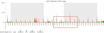

Apache Tomcat all thread, sometime hang
SocketInputStream.socketRead0 ,but cpu is very low。
os Windows server 12
windchill version 10.2 m230
Sometimes the CPU of the two front-end method servers is somewhat increased, but they do not perform gc at the same time. The same point is running this code SocketInputStream.socketRead0 。It is a system-level snow and does not involve specific operational functions.

i give  problem code:
"ajp-bio-8011-exec-22" Id=10442 daemon prio=5 RUNNABLE (in native)
Blocked (cnt): 1978; Waited (cnt): 1366
CPU nanos: 172000000000; User nanos: 151890625000; Bytes allocated: 27385700440

There is not enough information to assist you. You did not include Windchill version or OS. Let the field know what you've tried or if this is related to a certain action. The partial error message you posted is very generic and not helpful. I would also not classify this as "super big bug" since it may just be a tuning issue.
August 6, 2024
every 2 hour snow,but no gc
