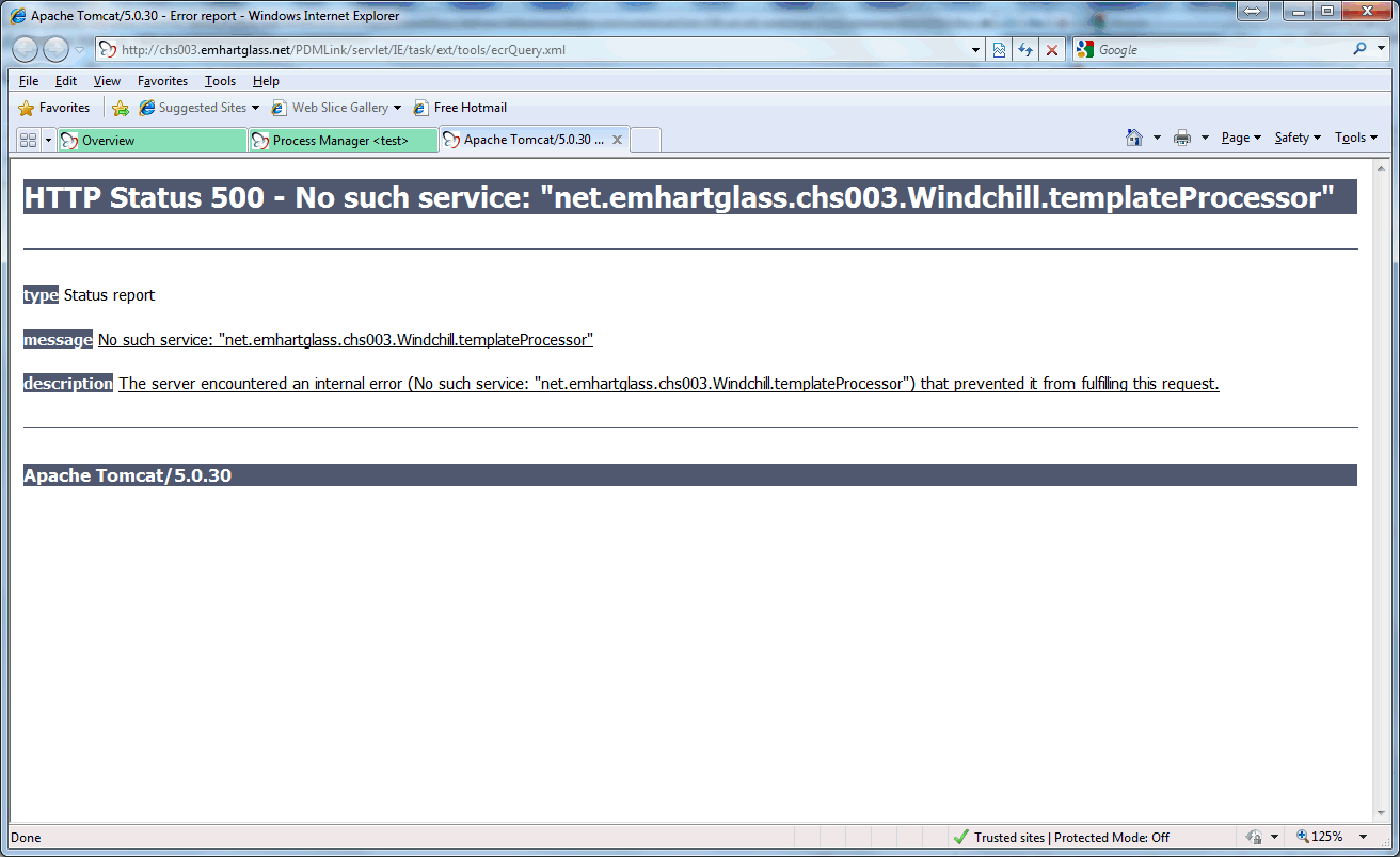

Windchill 8.0 M020 (I know, I know. We need to upgrade)
Guys,
I have a task with a very simple Query-Object webject. It worked fine
yesterday but not today.
This problem/error seems to come and go.
I've tried hard coding the INSTANCE and also adding Java code and passing
a String to the INSTANCE data.
I've deleted the compiled tasks.
Any thoughts on this?

is your XML something like below:
String instance =
wt.util.WTProperties.getLocalProperties().getProperty
("wt.federation.ie.VMName");
<ie:webject name="Query-Objects" type="OBJ">
<ie:param name="INSTANCE"&lt;br"/>data="<%=instance%>"/>
<ie:param name="TYPE"&lt;br"/>data="wt.change2.WTChangeOrder2"/>
<ie:param name="attribute"&lt;br"/>data="number,name,state.state, " delim=","/>
<ie:param name="WHERE"&lt;br"/>data="number='12345"/>
<ie:param name="GROUP_OUT"&lt;br"/>data="ecn"/>
</ie:webject>

I also have the same problem. Sometimes, when I clean compiledTasks and restrat all WC services, along with WC DS, the error goes off. Have notified PTC about this, but no response yet.
May 25, 2012
Delete the /tmp/ptcServlet ? Or Windows it's C:\tmp or D:\tmp (usually)
Was everything shut off when compiledTasks/file/ was cleared out.
Tomcat cache?
Have you tested other Info*Engine scripts such as the request echo page or
other examples provided?
Is Info*Engine running as a separate server or embedded into Windchill
Method Server?

I will try out these for sure. I*E is not running separately in my case.
