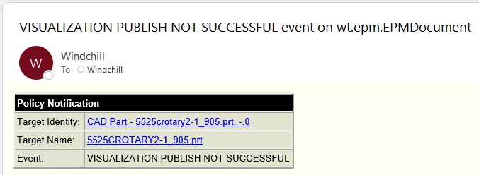

Windchill Visualization Representation failed without any program reaction
We have no program reaction if WVS monitor job failed or if the visualization of some objects was not done at all. We just have no visualization and no one knows about it.
Can we made some program reaction? For example email notification if something goes wrong with it...

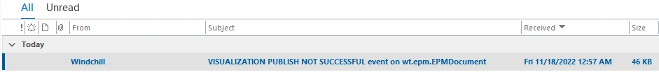

As @Marco_Tosin provided in the links, it's always been possible to send email notifications to an administrator when publishing fails.  I have a rule setup in Outlook to send these to a specific folder.  It makes it very easy to see when something fails.

I wrote a utility that will email whoever needs to be notified when a publishing job fails. Or if a publishing jobs fails for a specific reason such as regeneration failure or the CAD Worker simply failed to start.
The utility is fired whenever a job fails. If the job fails the jobs log is read which tells us why it failed.
The email body includes the log so that the admin or whoever gets the mail can quickly see why the job failed and what was being published.
I like this approach as it largely answers why the job failed which always help when trying to resolve the why.
