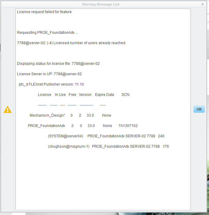

Our company has recently implemented Windchill. We have 2 floating licenses for Creo on our server. One of the interns over the summer was responsible for getting everything set up and working properly. One of the tasks he had to do was get the thumbnails to work and be able to view the models that were created in Creo.
He thought that it was setup correctly, but now Windchill ties up one of the floating licenses and only 1 user is able to use Creo at a time which is a major issue. From my understanding, the visualization shouldv'e come with it's own license, separate from one of the creo licenses we have. Also, my manager had been receiving job failed messages about every hour for a few weeks now. I may have found what that issue is but I want to put an example message here incase it is related somehow.

Yes, one visualization license comes included with Windchill. It's called "Creo Foundation for Visualization". You just have to ask your reseller for it. If you intend to run multiple sessions of Creo on the same computer at the same time (and only use one license), then make sure you request a node-locked license instead of a floating license.

You will continue to use your two floating licenses for normal Creo usage. Only the publisher will be using the visualization license.

I may have come across an issue with the license being tied up. I had an issue with the worker that was setup in Windchill by the previous person. The status for the worker was Failed to start. I would try to manually start the worker and it would just close out and the log file was:

I was able to get into Creo with the worker status being Failed to start.
I was given access to the server that Windchill is installed on and I decided to try and start the worker again. This time it started up without an issue. However, I went to open Creo and I received the same error as I did before saying there isn't a license. I manually stopped the worker and re-opened Creo and it worked fine. So for some reason the worker is using one of the 2 floating licenses for Creo. I spoke with a guy this morning that was helping the previous employee fix this issue and he said that this license issue should be a simple fix with just pointing Windchill to use the correct license that should be used for Creo View and not one of the 2 floating licenses on the server.
Anyone have a walk through? Or maybe its as simple as the worker was setup wrong??
September 4, 2014
The recipe (.rcp) file will list the path to the Creo startup command. Probably something like "C:\Program Files\PTC\Creo 3.0\F000\Parametric\bin\parametric.bat". Whatever the name of the batch file (.bat), there will be a corresponding setup file (.psf). Look in this file for a line that starts with "ENV=PTC_D_LICENSE_FILE". This tells Creo where to pull the license. If it's using a floating license, it will list the port and host. If it's using a node-locked license file, then it will list the path to the file.

But how do I get Windchill to stop using one of the floating Creo licenses? When I open Creo while someone else has it opened, this is the error for the license I get:
To my knowledge, only Windchill should be on server 4 and both floating licenses for Creo are located on server 2
