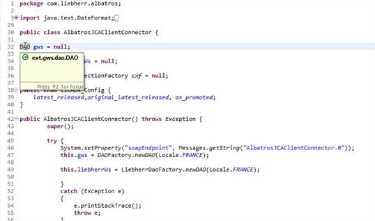

I'm using a java client that implements a Data Access Object (from PTC) which makes calls to the Info Engine's generic web service (GWS). I found it much more easy than using the WSDL thing in your code...
[cid:image004.jpg@01CDA714.E0730030]
AlbatrosJCAClientConnector.0 gives the GWS address: :<password>@<server<http: %3clogin%3e:%3cpassword%3e@%3cserver=">">http://<login>:<password>@<server<http: %3clogin%3e:%3cpassword%3e@%3cserver="> adress>/Windchill/servlet/RPC?CLASS=<name of=" the=" gws="> (name of your gws should be given in your WSDL file.

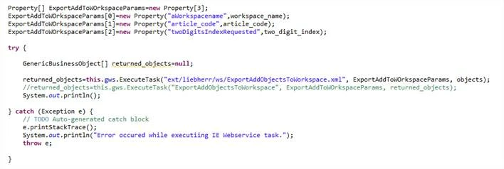

Then you can simply use your DAO instance like this (here calling a customized IE task that has been exposed in the GWS):
[cid:image007.jpg@01CDA714.E0730030]

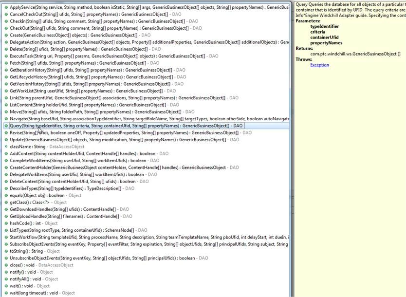

Here the list of standard services exposed by PTC:
[cid:image008.jpg@01CDA714.E0730030]
Does it helps?
