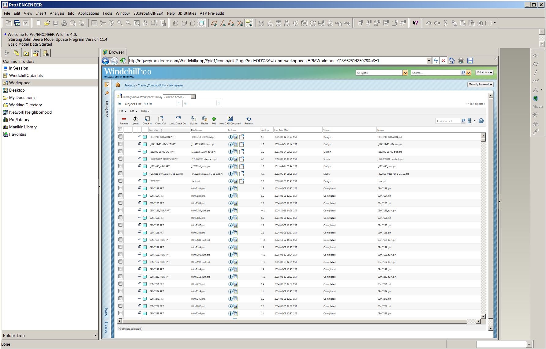

hello guys i need some help. Some weeks ago my company installed Windchill 10 for all the workstations but mine had some problems.. window zoom is far and i cannot see clearly i have tried to change configurations to my internet explorer but i cannot fix this... anybody knows how to change the window zoom? i have tried to modify some parameters in java but i'm not an expert and maybe i would be affecting more than correcting the problem. thanks in advance if i get an answer...

Miguel,
Can you post a picture of your screen ? That sould help to understand.
Morgan
October 11, 2012
here's the screen, i'm using Pro/E wildfire 4, and the web browser is microsoft internet explorer, i have tried on windchill screen going to: Quick Links-My Settings-Preferences.... changing some parameters but i don't get any modification.

in Pro/E or Creo the browser is like a pop up window and those commands Ctrl-+ or Ctrl-scroll don't work that's the problem i have.
June 3, 2013
We have the same problem on a single machine using Wildfire 4 and Windchill 10. Windchill interface looks fine in standalone browser but all text is tiny as shown above in the embedded browser. PTC's only recommendation was to upgrade to Wildfire 5.

Ctrl + scroll wheel on mouse.
June 4, 2013
Yes, we are aware that Ctrl + scroll wheel is the same as <Ctrl +> and <Ctrl ->. The standalone browser responds but the embedded browser does not.
June 4, 2013
Interesting it works for us. You can also try changing windows_browser_type to Mozilla, or IE in seperate process.
