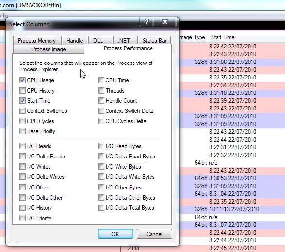

Does anyone know how to get the uptime from the CAD and or office
worker? Not the OS uptime but the actual amount of time the worker has
been running. It may make sense in the case of the CAD worker to break
that up into how long each of these components has been up
GS Daemon
workerhelper.exe
workermonitor.exe
xtop.exe
Any ideas or thoughts are appreciated.
--Bob
July 22, 2010
Hello
You can use sysinternals process explorer (google for it to find the download link) and add the start time column. Do this by right clicking on a column header and choose add columns. The Start Time is under the process performance tab.
