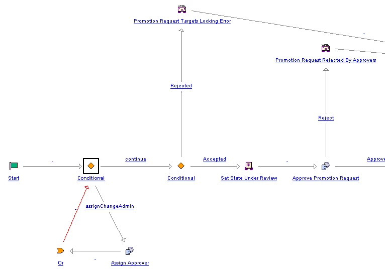

Hi guys, this one is giving me trouble. I have some legacy code I'm trying to update and bring forward. Basically the code checks to ensure one of many people are included as Approvers. If they are included directly (user added directly) it works fine. If they are included via a group, it does not work. Used to work in 9.1. Any ideas? I hope I'm missing something simple here. Thanks!
The Problem:
* In the 9.1 system, the system was capable of checking the group to see if one of the users was in the group.
* In the 10.1 system, the system is no longer recognizing that there is one of these "approved" users if they are in a group and not individually selected during the promotion creation request.
o So these are the scenarios:
1. User is member of approver role = Working
2. User is selected individually on promotion request creation wizard = Working
3. User is a member of a group on the approvers role = Not Working
4. Uses is a member of a group selected on the promotion request creation wizard = Not Working
The Setup:
* The Conditional block has code which is meant to determine is one of a few users was selected by the person creating the promotion request.
* If One of the users was not selected, the creator would get a task to assign on of the users
* There is a managers group associated to the approvers role and one of the listed users is a member of the group
[cid:image001.png@01CF684C.E81EF5A0]

7 replies

When I run the code it prints out this (the group name) instead of the user obviously.
2014-05-06 12:33:19,454 INFO [WfPropagationQueue.PollingThread] wt.system.out administrator - get the first principal
2014-05-06 12:33:19,454 INFO [WfPropagationQueue.PollingThread] wt.system.out administrator - principal = Engineering Manager Group

Steve,
You need to modify the code to validate the result enumeration value is a WTUser or WTGroup,in this case it is wtgroup.
if it is WTUser , the existing code will work fine else look up the user as member on resulted group.
hope this will help you.

Option 1:
Use user id instead of full name. Add code to do the type check and then type cast to WTUser.
String userID = wtUser.getAuthenticationName();
Option 2:
I don't remember exactly, but when principals are calculated from workflow, it automatically get users even groups are assigned to roles.
But this behavior is different when you extract principals from Team object.
I would recommend to rewrite the code to consider principals to take care of WTUser/WTGroup/WTOrganization if option 1 not works, still you need to user userID instead of fullName.
Run the recursive check for groups and group might have groups + users......
Ayyappan

You can check if the principal is a group or a wtuser like this:
wt.org.WTPrincipalReference principalref = (wt.org.WTPrincipalReference)principals.nextElement();
if(principalref instanceof wt.org.WTUser)
//wtuser
System.out.println("Here at a user: user name = " + principalref.getName());
else
//group
System.out.println("Here at a group:: group name = " + principalref.getName());
wt.org.WTGroup wtgroup = (wt.org.WTGroup)principalref;
for(java.util.Enumeration en = wtgroup.members(); en.hasMoreElements();)
//member of a group
wt.org.WTUser wtuser = (wt.org.WTUser)en.nextElement();
System.out.println("Here at group for loop at a user: user name = " + wtuser.getName());
May 6, 2014
Thanks guys, the method below (from a couple of other users too) worked well!
