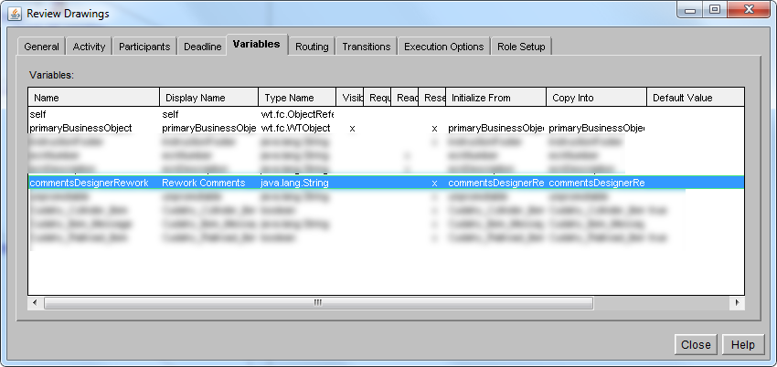

I have the scenario where 1st the Review Drawings task.  And 2nd, the Rework Drawing Change task (if that route is chosen).  Refer to it below.
So I have the process variable commentsDesignerRework, as we've already discussed.  In your implementation, you can call the variable name whatever you wish.  But for the example, I will stick with this for consistency.

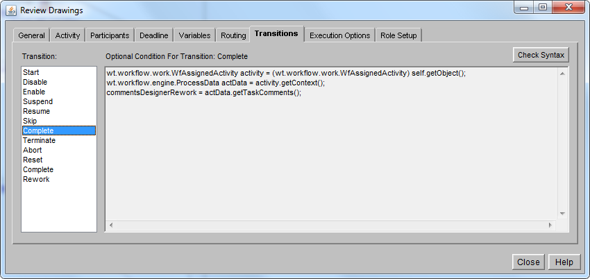

In the Review Drawings task, I need to add the commentsDesignerRework variable in the Variables tab.  And then add that 3 lines of java code to get the task comments and assign it to the commentsDesignerRework String variable.  Refer to the 2 screenshots below.

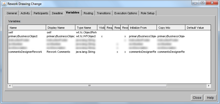

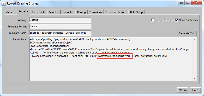

Then, I need to take a look at that 2nd task - the Rework Drawing Change task.  I also need to put that variable in the Variables tab of the workflow task.  And then in the instructions, call that variable out as {commentsDesignerRework}.
I think at a minimum, what you're missing is adding the commentsDesignerRework variable to the Variables tab of the 2nd task - the Rework Drawing Change task in this example.  When the workflow task instructions (and the email notification) render strictly as {commentsDesignerRework} instead of the actual value that is stored in that variable, then that is a tell-tale sign that the variable is missing from the Variables tab of the workflow.

This can get you started, perhaps.  In my case, I create a process level variable (such as commentsDesignerRework in the example below).  And then in the Complete transition of the task, enter this code:
wt.workflow.work.WfAssignedActivity activity = (wt.workflow.work.WfAssignedActivity) self.getObject();
wt.workflow.engine.ProcessData actData = activity.getContext();
commentsDesignerRework = actData.getTaskComments();
That will pull the comments into the process level variable.  From there, you can carry it forward to whatever other tasks you want.  Or do whatever else you want to do with it.
The scenario I'm not sure about is when multiple users need to complete a task.  I guess if it is in the Complete transition, it will only grab the Comments from the last user that completed the task.
