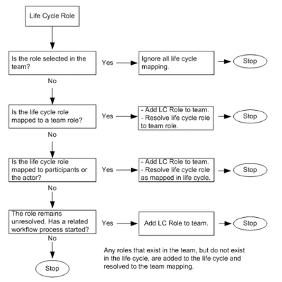

Aug 6, 2024 3:52 PM UTC
Could this be the issue? I have Roles in the Lifecycle. But in the "Open" workflow (create/submit) we only call out the submitter for that state on the Lifecycle. We do call out other roles at progressive states but each state has it's own workflow.
Default Behavior
The following list illustrates the order in which Windchill tries to resolve each role in a life cycle when the wt.team.re-resolveRoles property is set to the default value:
1. If the life cycle role exists in the team template, the life cycle role is resolved to participants (or the actor for the role), as defined in the team template. All life cycle mapping for that role is overridden by the team values.
2. If the life cycle role does not exist in the team template (that is, rule 1 does not apply), but the life cycle role is mapped to an existing team template role, then the life cycle role is added to the team and resolved to participants, as defined in the team template role.
3. If the life cycle role does not exist in the team template and is not mapped to a role that exists in the team template (that is, rules 1 and 2 do not apply), then the life cycle role is added to the team and resolved to participants, as defined in the life cycle.
4. If the object’s context team contains the role, any participants who play the role in the context team that are not already members of the role in the team are added to the team.
5. All roles that are not defined in the team, but are used in a related workflow process, are added to the team when the workflow process starts.
6. Any roles in the team template that are not used in the life cycle are also added to the team.
The following flow chart illustrates the Windchill business rules for resolving life cycle roles:

LG_1009615414-AlexandriteAuthorAnswer
Aug 12, 2024 1:54 PM UTC
The issue seems to be basic functionality.
The workflow process looks at the Team Template called out on the OIR, that team template calls out Roles and those Roles can have user names in the Roles.
If that same Role is named in the context team then the workflow can pull users from that Role as well. The idea is that the team template can just name the Roles used in the workflow and the context team role can be managed to add users to that Role.
If there are no users in either the context role or the same team template role then EPDM send the task to admin account.
What we need to do here is to inform the context managers that they should not add users to the workflow roles (like Mfg Engineer)  if they do not have actions for that role and the context managers should place users in roles in the context that are designed for access (like Members or Guest).
