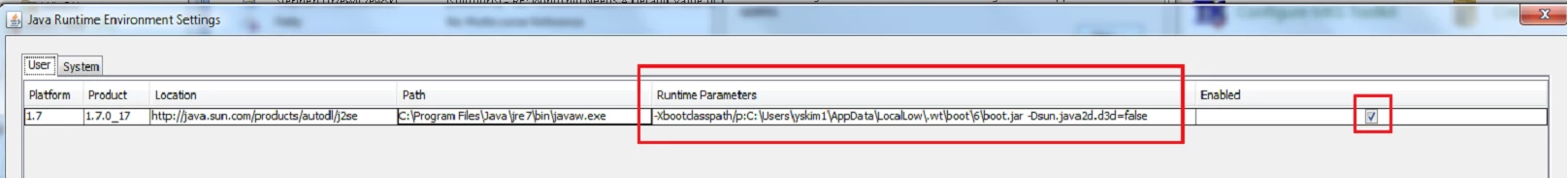

You can try such things as |-Dsun.java2d.d3d=false| in your Java Plug-In
options if that's the case.

I had the exact same issue on 10.1 M30, and resolved with PTC call.
[cid:image001.png@01CE45BB.AE827830]
Add what Jess informed and re-create the bootstrap classpath by renaming the .wt folder. When JVM is invoked the boot.jar file will be located in the same classpath, and the .wt folder will be re-created.

April 30, 2013
For those whose video cards don't agree with their Java versions, the
important piece here is the "-Dsun.java2d.d3d=false" portion.
The bootclasspath piece isn't necessary in any recent version of
Windchill -- nor is the other approach of installing boot.jar in your
JRE's lib/ext folder. I think it stopped being necessary in R9.1 M030.
The bootclasspath approach also stopped working with some Java 6 update
or another...
