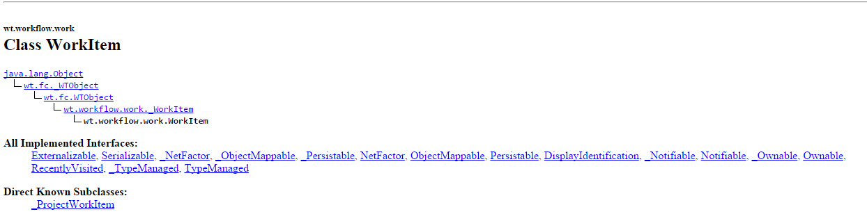

Hi!
I want to create an access rule for workItem, but I can't find the object type in the structure. Any idea?
Best answer by LoriSood
Anton,
It doesn't look like WorkItem objects are access controlled. They do not implement the AccessControlled interface:
LoriSood23-Emerald IIAnswer
23-Emerald II
September 18, 2014
Anton,
