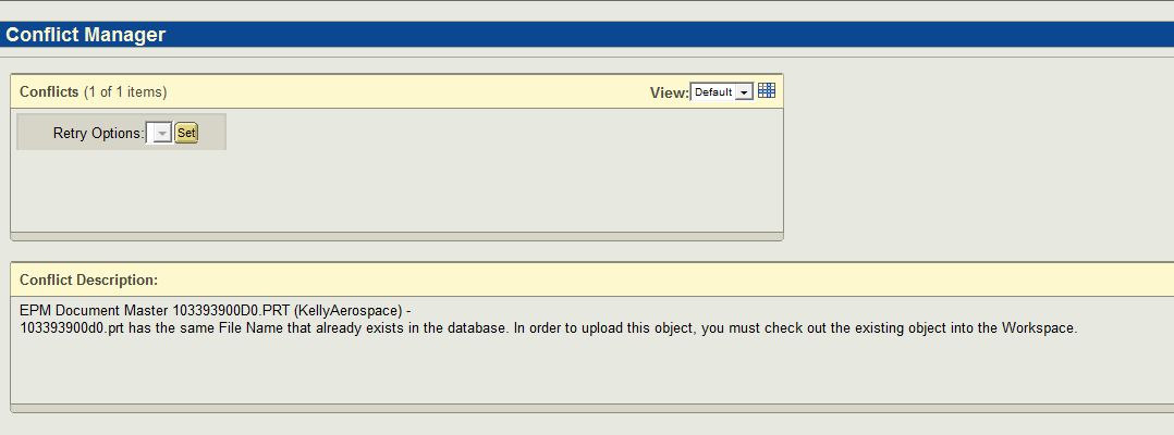

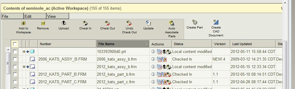

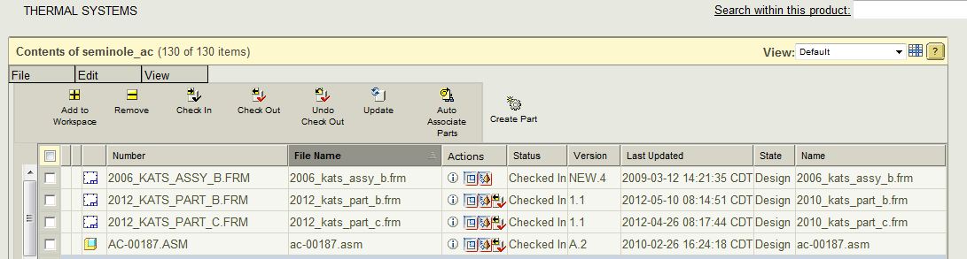

I am having a problem with my workspces. Basically The simple explanation is that I have had difficulty checking CAD documents in and out and my workspace. The view of the workspace in pro-e does not agree with the view of the workspace in Internet Explorer. For instance i have tried to remove a cad model from my work space ( 103303000d0) I got a failure in Event Manager.
But when I check the same workspace in Internet Explorer the CAD document is not there.
Workspace as shown in PRO-E
This all happened because I was working on a project and I was not able to work in the workspace at all; I could not check CAD documents in or out, I could not add CAD doocuments to the workspace. So I Backed up my assembly and I finished the project on the network drive out of Windchill. Now I have to get parts back into Windchill. This particular item is one that existed previously in windchill there are others like this.

Viewing your workspace in Pro/E views the client-side workspace by default. The client-side workspace is a copy of the workspace that exists on your local computer. Viewing the workspace in IE only views the server-side workspace (objects that exist in the copy of your workspace on the server).
The most common reason there is a difference between the two is when you save an object (at which point it is displayed in your client-side workspace) but have not yet uploaded it (at which point it will also appear in your server-side workspace). You can hover over the icons in the notification columns to gather information on the status of each object in the workspace (new, modified, not yet uploaded, etc.).
