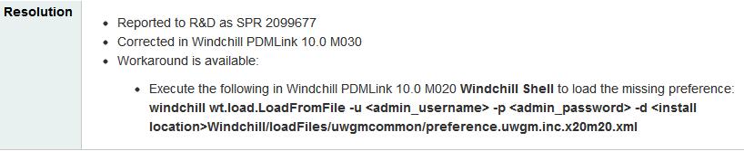

I have users both in the US and in India that are receiving this error when trying to check in objects into the system. So of course having no clue as to what this meant other than it has the word java in it, I proceeded to let tech support try to help. They came back to me with the following change that they say needed to be made in Oracle:
I had IT execute this in the system and it completed successfully, but yet the problem still remains....
