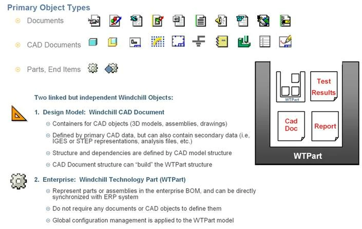

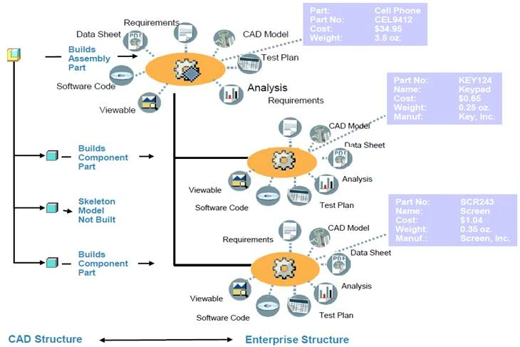

Thanks... I love the slide deck, and I will use some of this content to
help sell Winchill internally!
What I struggle with is, our initial implementation will be a
replacement for Pro/INTRALINK, so the WTParts diagram will look like

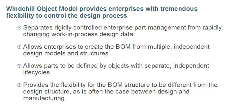

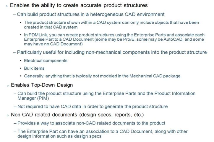

As Steve D said already, just do the WTParts after migration. I would not turn them on until you think you are ready.
To answer your question, if you are not associating other things to the WTPart there probably isn't a tremendous amount of value in creating them, though they are the foundation for many other things like Configuration Management and to some extent Change Management (though they are not needed for this).
Also, if you ever plan on interfacing to MRP/ERP you will need them.
But I'll stress again, a lot of folks mention what you mention below: "confusion and extra baggage", but I don't think this is really the case, when I was a Windchill Admin I set a lot of preferences so that my guys never hardly saw the WTParts. You still need to sell the advantages internally as you mention, but also make sure you assure Engineering that they really aren't much extra baggage - what little extra baggage they do incur provide ENTERPRISE benefits downstream.
But if you are still on Ilink 3.x I probably wouldn't create them during the migration - that probably IS quite a bit of extra baggage.

Even in the CAD environment, WTparts can be usefull. The images of the earlier postings disregard drawings, skeletons, flat states etc. We use WTparts to combine CADdocuments that should or could be considered together.
E.g. the ProE-assembly is coupled to it's proper WTpart together with its drawing and its skeleton.
E.g. the family table instance is coupled to it's WTpart together with its drawing and the upper generic.
