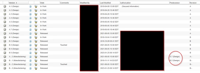

Revisiting old thread...again. Is it Groundhogs day?
https://community.ptc.com/t5/Windchill/Any-workarounds-for-quot-branch-point-quot-failures-when-purging/m-p/283085
https://community.ptc.com/t5/Windchill/Purging-old-WTPart-iterations/m-p/397907
https://www.ptc.com/en/support/article/CS18659?source=search
I would like to know the real deal behind this. PTC is not going to fix this but I can't see why not unless it has something to with WTPartUsageLinks getting all messed up. If to preserve history,  I can let that stuff go if it means I can clean up old iterations to remove holds on stuff I want to delete.
The image below shows that MFG view was created off A.7 which means you cannot purge this or anything after that unless you delete A.- (yes, this is how downstream view versions looked back in the day).
Seems like there should be a job or preference to just shift the branch point to the latest iteration A.8. I know there a SQL hacks and I could probably write something to fix it but just really curious about the internal 3rd rail that prevents PTC from fixing this. Why is this a complicated fix?

This is a very good question that PTC needs to chime in on.

Its only been 10 years 😉
