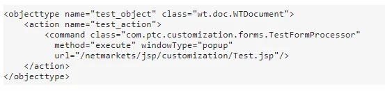

can you please explain the detailed steps to registered JSP files ?
I registered Datautility, added property file location into  "TgsPropertyHelper". but not getting idea how to register the "createDocumentSetTypeAndAttributesWizStep.jsp" and "loadStateNames.jsp" JSP files ?
please find attached file for reference

Please download a Customization guide and search for custom/wtCustomActions.xml where the actions are defined
https://www.ptc.com/en/support/article/CS60345
page around
1616 Add Custom Commands
or help center
Server Side Customization

My question was in reference to below attached file.

You don't need to register jsp pages, Just store them to the codebase/netmarkets folder to respect your package and use them in browser.
In some cases the location is in web-inf folder...
PS> if you share your problem, and describe some more details of your work with errors it could help to understand your issue,
