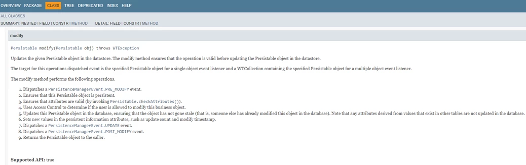

HelesicPetr
May 10, 2024 8:16 AM UTC
Hi @AK_10639313
Additional info.
Sometimes It is very useful to check the JavaDoc documentation to understand what the service can do.
PetrH
