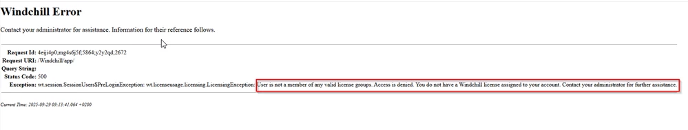

I am using Windchill PDMLink Release 13.0 and Datecode with CPS 13.0.2.2
We are currently using Windchill version 13.0.2.2 in our organization. We've observed that some users are attempting to access Windchill without being assigned any valid licenses. In such cases, the error message displayed is overly technical and difficult for end users to understand.
To improve the user experience, we would like to customize the error page to display a simple and clear message indicating that the issue is due to missing Windchill licenses. I’ve attached a screenshot of the current error for reference.
This request is of high priority, as the existing error page is causing confusion among users and generating unnecessary support tickets.
Thank you for your attention to this matter.

    Sep 29, 2025 1:07 PM UTC
    Try below on a test server before touching any prod :
    1. Copy Windchill/src/wt/licenseusage/licenseUsageResource*.java and paste to Windchill/wtCustom/wt/licenseusage/ - Create folder manually if not exist
    2. Edit below message @RBEntry in Windchill/wtCustom/wt/licenseusage/licenseUsageResource*.java with proper language
       @RBEntry("User is not a member of any valid license groups. Access is denied. You do not have a Windchill license assigned to your account. Contact your administrator for further assistance.")
       @RBComment("Message stating that Failed to login because user is not member of any active license group")
       public static final String INVALID_USER_LOGIN_FOR_ACTIVE_LICENSE_GROUP = "INVALID_USER_LOGIN_FOR_ACTIVE_LICENSE_GROUP";
    3. Stop Windchill
    4. Execute command in Windchill Shell: ant -f bin/tools.xml class -Dclass.includes=*.java -Dclass.source=%WT_HOME%\wtCustom\wt\licenseusage\
    5. Restart Windchill
