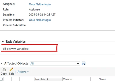

Even though setting is on, this value is not visible at all. Is there anything else we should check?
Reference of topic
Even though this setting is on, this value is not visible at all. Is there anything else we should check?
We called PTC support. We did not get a response from there either.

I checked all of these. There is no error. I get this error not only when I want to create a ".class" but also when I want to create an empty variable.

You said there is no error, and then you are talking about the error.
Please can you share where is your variable defined take a screenshots of the workflow definition and the variable.
There are several settings that you can allow to see the variable or not see in the workflow.
