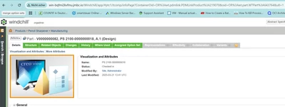

Use Case: How to use the PTC.ProdMgmt.GetBOM with the POSTMAN App?
Description:
Hello community, In my case i want to fetch some data from my BOM (in the picture)
so i need to fill the parameters

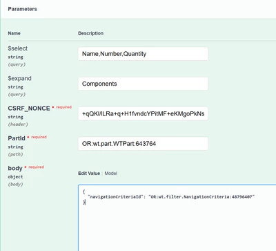

I've used the PartID from the first picture in the URL, the CSRF NONCE i got from this Link http://<Windchill HOME>/Windchill/servlet/odata/PTC/GetCSRFToken()
and copied the code  in the CSRF_NONCE Field
i am not sure what to type in the body can I let it emty?

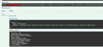

when I click Execute i get the Link with error code 400

Are you sure the part you queried has a BoM, I noticed the version is A.1
