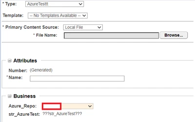

When the user starts the Wizard by selecting “New Document,” there are two different comboboxes in the opened window.
  • Combobox1 holds a list of repository addresses.
  • Combobox2 should hold the folder names within the repository based on the "selected" repository attribute value in Combobox1.
I can dynamically retrieve the values for Combobox1 with a data utility as soon as the window opens, and this works without any issues.
However,
My question is: How can I populate Combobox2 with the desired values based on the selected value in Combobox1? (Both of the comboboxes must be dynamic)
In the Create New Document Wizard, the values in Combobox2 should dynamically change based on the selection in Combobox1.

I solved the problem by these steps;
1- Created DataUtility for Combobox1 for get Repo Names from Azure, added Js action
comboBox.addJsAction("onchange","TestScript()");
2- Then edited CreateWizStep
3- Created Servlet for parse folder names.
