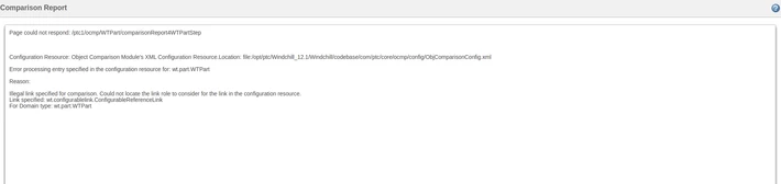

I made the changes you mentioned above, but I’m encountering an error
May 9, 2025 1:00 PM UTC
It's difficult to help without any logs etc. I would say you forgot the following entry:
wt.configurablelink.ConfigurableReferenceLink=RELATED_DOCUMENTS
