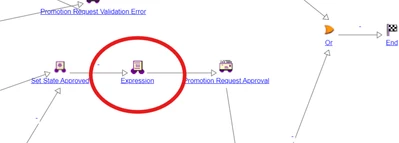

Alter Your PR
Find Your active "Promotion Request Template" within Yours "Windchill Template Administration" panel.
https://support.ptc.com/help/wnc/r12.0.2.0/en/#page/Windchill_Help_Center%2FWFAdminAbout.html%23
Edit, or better duplicate and edit Your PR.
Insert a Expression block between "Set State Approved" and "Promotion Request Approval"
Insert this code to the "Expression Block":
// This first block gets the approver's information
// get the principals selected for the APPROVER role
java.util.Enumeration principals_approver=((wt.team.Team)((wt.workflow.engine.WfProcess)self.getObject()).getTeamId().getObject()).getPrincipalTarget(wt.project.Role.toRole("APPROVER"));
// define STRING for approver's information
String approver_info = ""
// loop through all approvers, which were selected for this PR
while(principals_approver.hasMoreElements())
// get account object of current approver
wt.org.WTPrincipal wtprincipal = ((wt.org.WTPrincipalReference)principals_approver.nextElement()).getPrincipal();
// returns approver with Email address
approver_info = wtprincipal.getUniqueDisplayIdentifier();
// This block alters the attributes of the objects in the PR
// from https://community.ptc.com/t5/Windchill/Java-Code-to-add-Windchill-IBA-Values-to-WTPart-Object/m-p/418583
wt.maturity.PromotionNotice pn = (wt.maturity.PromotionNotice) primaryBusinessObject;
wt.fc.QueryResult qr = wt.maturity.MaturityHelper.service.getPromotionTargets(pn);
while (qr.hasMoreElements()) {
 java.lang.Object obj = qr.nextElement();
 wt.iba.value.IBAHolder ibaHolder=wt.iba.value.service.IBAValueHelper.service.refreshAttributeContainer((wt.iba.value.IBAHolder)obj, null, null, null);
 wt.iba.definition.service.StandardIBADefinitionService defService=new wt.iba.definition.service.StandardIBADefinitionService();
 wt.iba.value.DefaultAttributeContainer attributeContainer=(wt.iba.value.DefaultAttributeContainer)ibaHolder.getAttributeContainer();
 wt.iba.definition.litedefinition.AttributeDefDefaultView attributeDefinition=defService.getAttributeDefDefaultViewByPath("com.example.attribute.released_by");
 wt.iba.value.litevalue.StringValueDefaultView attValue= (wt.iba.value.litevalue.StringValueDefaultView)attributeContainer.getAttributeValues(attributeDefinition)[0];
 attValue.setValue( approver_info );
 attributeContainer.updateAttributeValue( attValue );
 wt.iba.value.service.StandardIBAValueService.theIBAValueDBService.updateAttributeContainer(ibaHolder, null, null, null);
Save and checkin the changes You made to the PR.
