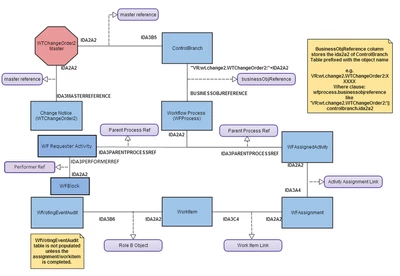

Actually,  I needed to fetch from wtobject directly the processes / tasks associated . Those tasks which are added in the workflow  not through change management
Preview
Finally saw this data model . It helped in digging deep in to the links.
After gettting the process details , we can fetch tasks, assignee etc
Here is the code (remaining portion i have attached in previous mail chain )

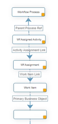

This is one way to get the info, using a report template:
The last link will be to whatever the Primary Business Object is for the Workflow
