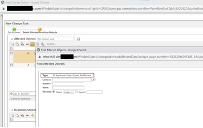

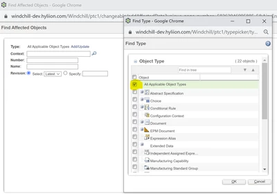

I want users to see or pick only part and document, and hide/disable all other types. Is it possible to customize this type picker
HelesicPetr
October 10, 2023
Hi @RG_10753677
You can use wt.typepickerexclude property
Check following articles that can help you
CS347566 - wt.typepickerexclude property
CS321943 - Excluding type per typepickerexclude

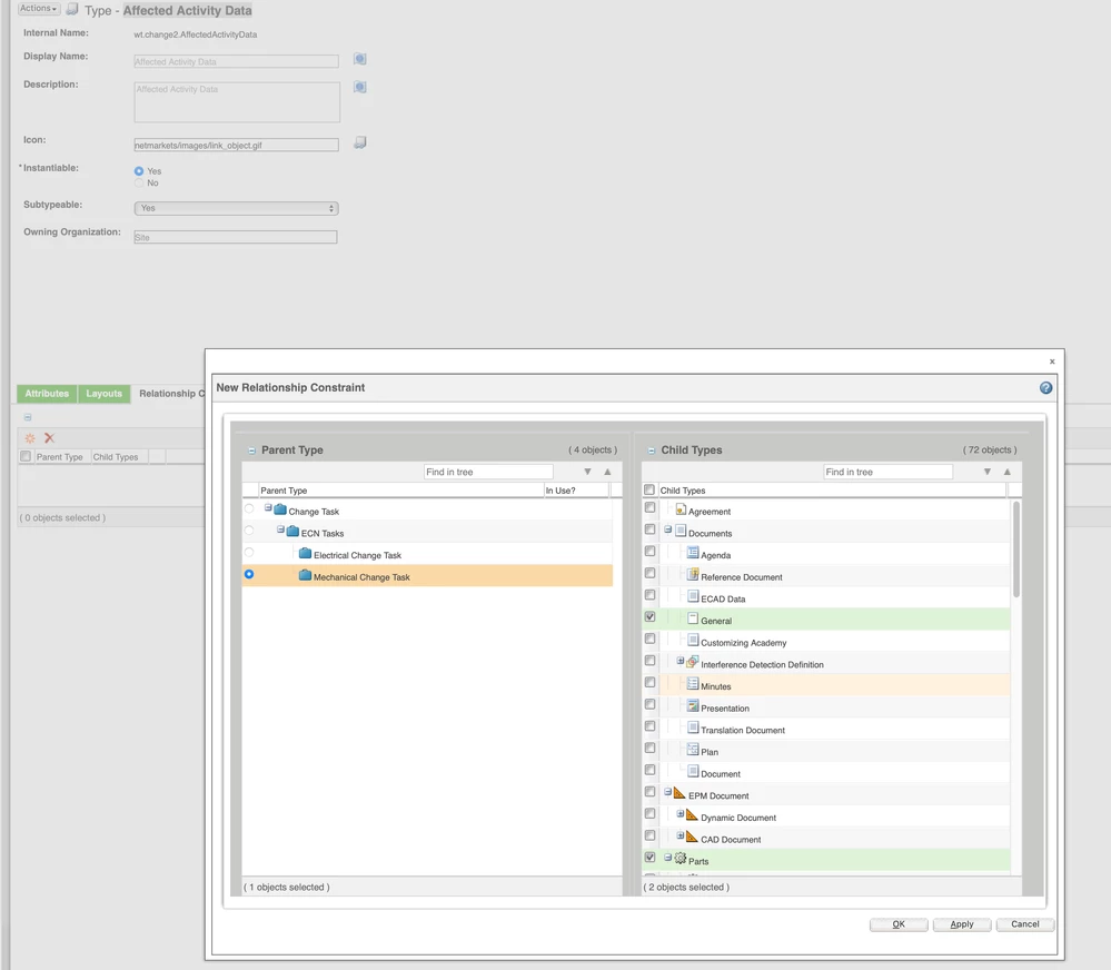

October 11, 2023
You don't need to customize that! Rather change the configuration of the link.
--> Go to the type and attribute manager and select the type "Affected Activity Data"
--> select the tab "Relationship Constraints" and make the appropriate definition. You can do that for all change task types or just for one.
If you need to have that also for resulting object, do the same for the "Change Record" link.
