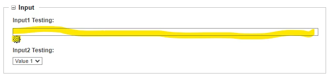

My problem is that I can't find the right combination of ComponentType so the label and the input are aligned horizontally. So far all I can get is aligned vertically. Screenshot of what I am getting:

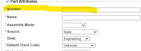

and screen shot of the ootb New Part wizard attributes, note the Label and the input are aligned horizontally, which is how I want mine to look like:

@Sandeep_S_Desai the only thing this changes for me is the text input will span whole row and put the icon below, for input1, if colspan is greater than 1.
input1 .setColSpan(2 <or greater>); results in this:

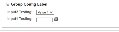

20-Turquoise
Aug 14, 2024 2:27 PM UTC
@BjoernRueegg wrote:
Not sure, but try setting this to false:
groupConfig.setRenderOnTop(false);
As I remember, this is the label rendering. So the label is being rendered on top and not left side.
That is it!! Not sure why I had not tried that yet. Setting this to false (which is the default) the labels and inputs are rendered aligned horizontally:
