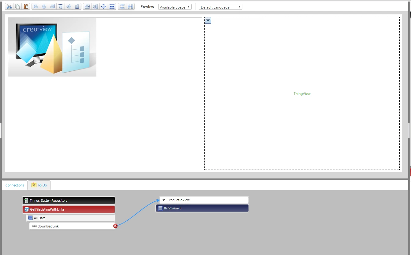

I want to display 3D model in Creoview or Thingview, but as I bind 3D model to that widgets it's shows nothing.
please find attached img for linking ref.

so as shown in you picture you tried to display the model in 2 different views: Creo view and thingview.
For creo View - if you try to  display you mashup in chrome - it will definitely not work. It work only on windows explorer where activeX are allowed. So that I do not think, that this is a real opton for usage.
So the second view thingview should work for pvz models.

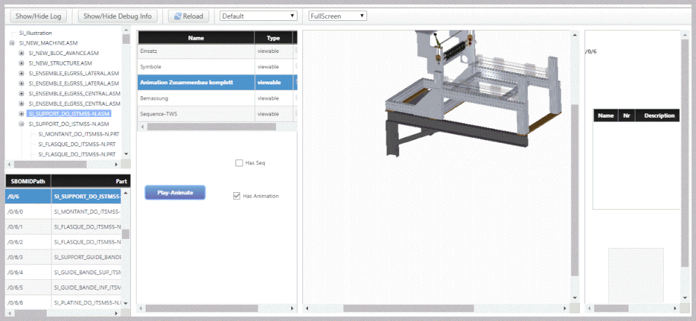

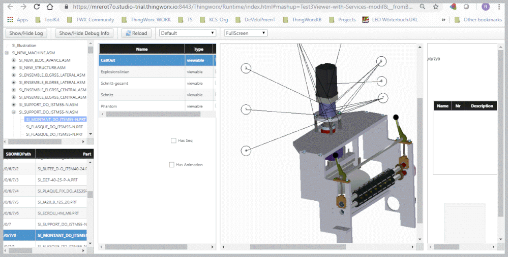

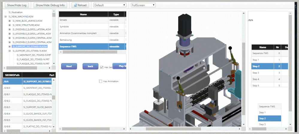

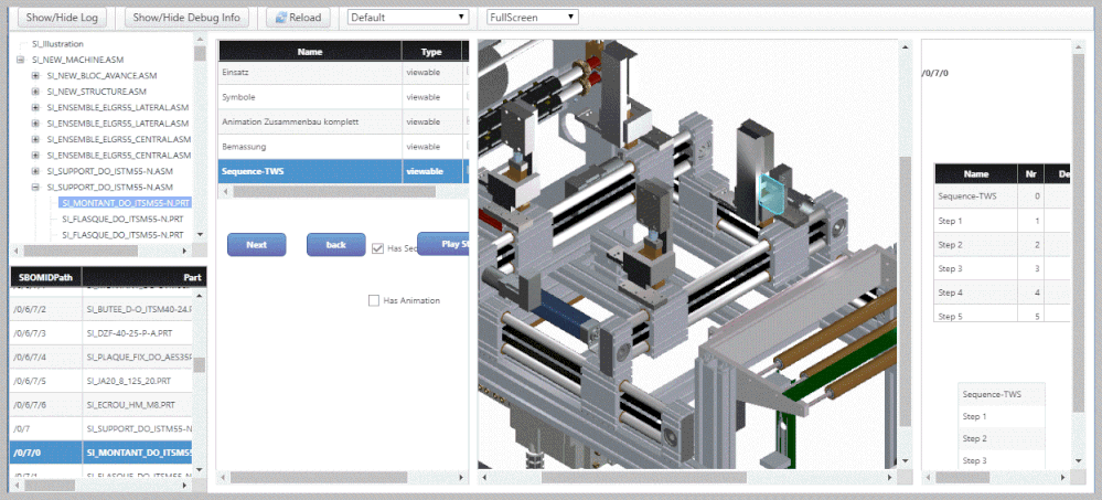

Here example (in pictures):
Here example for sequence and selection on element tree (requires boom see Tech Tip on AR Studio community😞
Also animations are working too.
