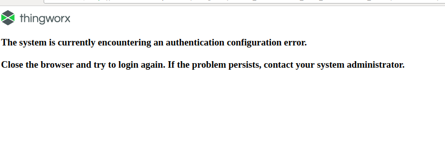

I have some problems with configuring SSO. I did all steps on this document https://support.ptc.com/WCMS/files/172779/en/PTC_Single_Sign_on_Architecture_and_Configuration_Overview_Guide.pdf  . I not sure about Scope, i did as on guide WINDCHIILL_READ. Is it right? At the moment i can login to thingworx trough sso but after I do changes in ptc-windchill-integration-connector and ptc-windchill-integration-connector-proxy i get this error
In Security log i found these errors:
2018-01-20 18:33:13.521+0300 [L: ERROR] [O: S.c.t.s.a.s.ThingworxSSOAuthenticator] [I: ] [U: ] [S: ] [T: https-jsse-nio-443-exec-4] [ Failed to utilize the SSO component for authentication ][ The requested scope(s) must be blank or a subset of the provided scopes. ]
2018-01-20 18:33:13.522+0300 [L: ERROR] [O: S.c.t.s.a.AuthenticationFilter] [I: ] [U: ] [S: ] [T: https-jsse-nio-443-exec-4] Could not handle request
2018-01-20 18:33:13.524+0300 [L: ERROR] [O: S.c.t.s.a.AuthenticatorExceptionHandler] [I: ] [U: ] [S: ] [T: https-jsse-nio-443-exec-4] errorMessage: [Unauthorized], statusCode: [401]
2018-01-20 18:33:13.524+0300 [L: ERROR] [O: S.c.t.s.a.AuthenticatorExceptionHandler] [I: ] [U: ] [S: ] [T: https-jsse-nio-443-exec-4] [ The requested scope(s) must be blank or a subset of the provided scopes. ]

Hi Iryna,
Seems like the SCOPE is not defined in correct way. We need to mention the same SCOPE in PingFederate and in Thingworx.
I'll suggest you to create a case with Support Services. A case can be logged with TS here

Any success on this, I am also facing the same issue
Security log is saying:

i'm also facing same issues ,kindly provide your comments.
2019-11-14 07:39:43.292-0500 [L: ERROR] [O: S.c.t.s.a.s.ThingworxSSOAuthenticator] [I: ] [U: ] [S: ] [T: http-nio-8181-exec-1] [ Failed to utilize the SSO component for authentication ][ Key for alias keystore not found ]

Please check if keyAlias is defined correctly in <ThingworxNavigate>/tomcat/apache-tomcat-8.x.xx/conf/server.xml
Also, make sure the Hostname for PingFederate, Windchill and Thingworx in the all configuration files and shortcuts URLs also uses as Fully Qualified Host Name (FQDN) .
