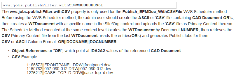

Gary Jackson‌, looks like you succeeded!  CS211115 has been updated to include CSV input.  Hallelujah!
Oct 8, 2015 7:39 PM UTC
Indeed, my colleague in Shanghai pulled out all the stops to update his sample custom scheduler methods with one that hopefully meets all your needs, or at least provides the code basis for one that does.  He even provided a command-line option the must be run by an admin on the Windchill server.
I've not had a chance to deploy this and validate it yet then again the idea is that you take this, modify it to your requirements and the fully test it in a development environment before deploying and using in production.
I'll post on the scheduler thread shortly but I hope it helps you Tom.
