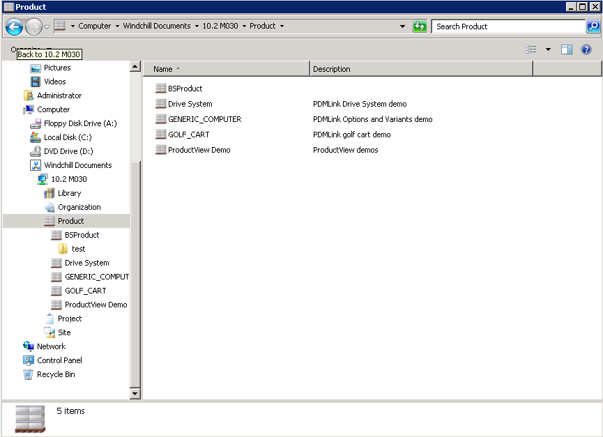

Windows Explorer Integration
The PTC Windchill Desktop Integration plugin adds the Windchill Documents system folder to your local environment. You can you use that Windows Explorer Integration to find, open, access and download Windchill documents without the need to open the Windchill web application in a browser.
This will give you a variety of ways to easily access and interact with documents just like they had been stored on your local system:
  • by double clicking on a file in the Windows Explorer
  • by using the context (right mouse button) menu on the Windchill node, any context folder or document in the Windows Explorer
  • by the File > Open dialog of any local application (like Microsoft Word, Adobe Acrobat…)

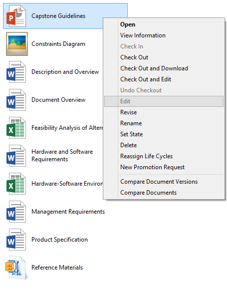

Access to Windchill Functionality
Starting with Windchill 10.2 F000, the right-click menu in Windows Explorer includes a wider range of Windchill actions. While in previous releases only actions such as Open and View Information were available, this expanded to the most commonly used actions on the Windchill web application (even multiselect for Check in, Set State… have been implemented in 10.2 M030).
The right mouse button menu is context sensitive and the actions availability will change depending on the object you open it on. Additional restrictions like access permissions, preferences and so on can have impact on the availability of actions.

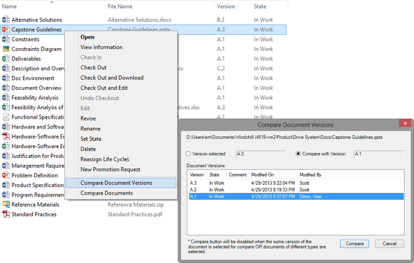

My personal highlight is the introduction of the Compare Document functionality in the Windows Explorer integration with Windchill 10.2 F000.
Compare Documents
Starting Windchill 10.2 F000 (and enhanced in 10.2 M010) the Desktop integration added compare capabilities. But different to the compare functionality available in the Windchill web application this will concentrate less on comparing metadata but more on comparing the content of the documents.
Out of the box Windchill supports Microsoft Word 2007 and 2010 files and had been extended to Microsoft Excel and Microsoft PowerPoint in Windchill 10.2 M010 (dedicated support matrix below).
Office Version Microsoft Excel Microsoft Word Microsoft PowerPoint
2007 No Yes No
2010 No Yes Yes
2013 Yes Yes Yes
Additional file compare tools can be registered based on the file extension in the Windchill Desktop Integration Configuration menu.
There are two different compare actions available:
  • Compare Document Versions
This will allow you to compare the file content of two different versions of the same document (see screenshot)
  • Compare Documents
This will allow you to compare the content of two different objects, which need to be of the same file type.
