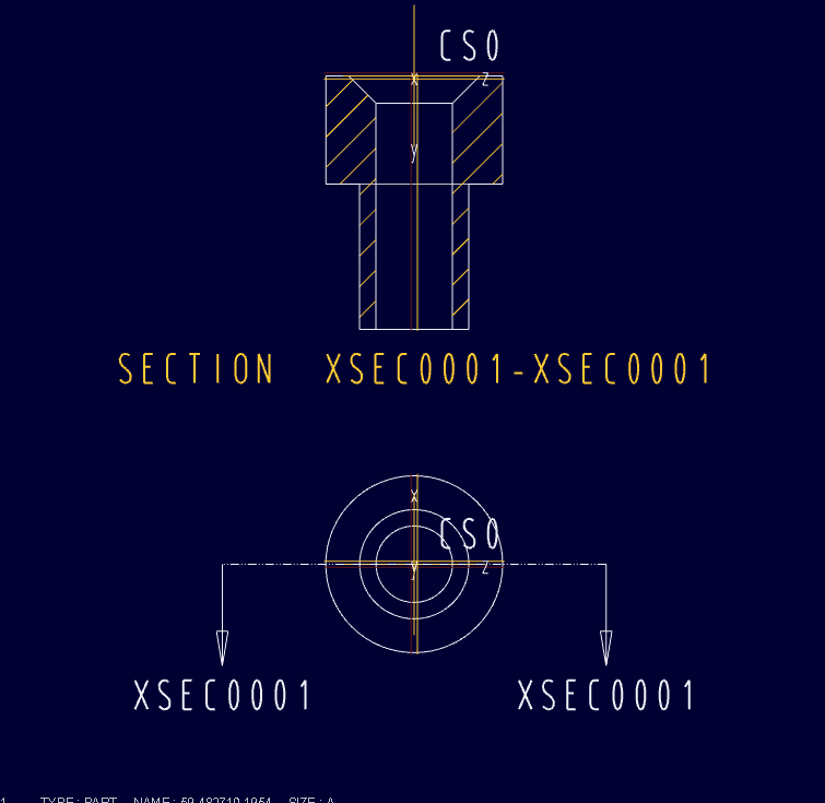

Tom,
in Creo Parametric 2.0 M070 I opened your model and performed following steps.
  • create new drawing
  • click General button on Layout tab
  • place view
  • in View Type category select LEFT or RIGHT view, click Apply
  • in Sections category select 2D cross section option
  • click button with green plus sign
  • select XSEC0001 section (marked by green check mark), click Apply
  • click Close
Martin Hanak
