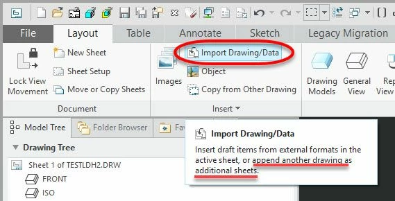

  • Create two separate drawings and combine them using the Import Drawing/Data command. Save 1st drawing created from template that has the desired file name, create 2nd drawing from another template 'in session' without saving, and with 1st drawing open, 'Import Drawing/Data' from 'in session' to add the 2nd drawing to the first drawing. The 'in session' portion is optional but allows the temporary 2nd drawing to be removed without having to save or delete files later. If you do this enough, you could create a Mapkey to speed things up.
