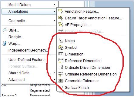

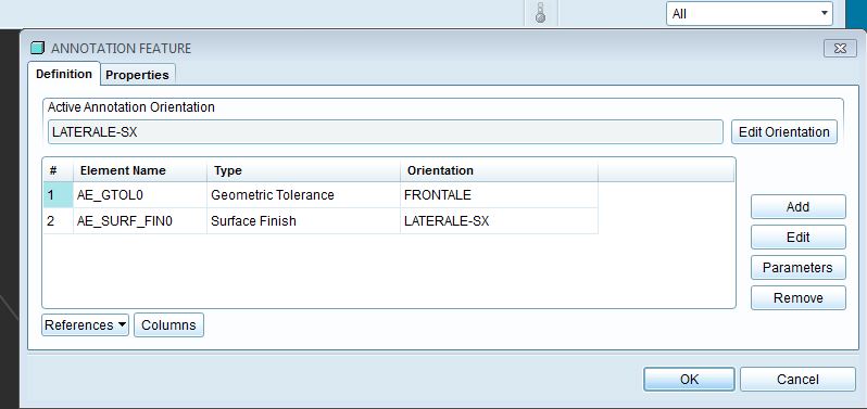

Hi all,
you can create a 3D annotation as a text with leader or a gtol, and this kind of thing is visualized at the top of the model tree.

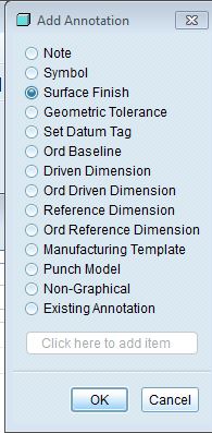

Next, you can create a 3D annotation feature, in which you can create a set of all the annotation (gtol, finish surface symbol...)
What is the logic that guides you to prefer one way instead the other one?
What is the advantage in using the first method or the second one?
PS: I use WF5.
Thanks.

Best answer by gfraulini
Thanks Brian to be intervened.
So between the "old" method (placing the symbols using the simple annotations) or the "newer" one (using the annotation feature) the only difference is that the newer unifies the simbols within the feature in the model tree instead of placing them at the top of the tree.
In addition, it is normal to have some problem in the positioning of this annotation becouse the tool starts to be efficiently since the creo 2.

Speaking specifically of the way this tool works in Creo 2.0 and 3.0, the primary benefit is that the annotation feature can hold several different annotations (as you pointed out). The first method is what I'd regard as the "older way" to use 3D annotations. The second method is the "newer way". Even as late as Creo 2.0, annotation features can be finicky. Some work well (GTOLS) and others do not (weld symbols).
This problem is compounded by the fact that there are several different ways to create certain annotation types. For example, I can think of 3 ways to set a datum plane (for GTOL purposes). What's worse - sometimes one method works while the others do not! This makes the entire affair challenging and, at times, very frustrating. Creo Parametric 3.0 has improved the consistency a little - but there are still multiple ways to create these 3D annotation features. There are also several functionality gaps still being addressed.
In general, Model-Based Engineering (MBE) or Model-Based Design (MBD) is the latest trend. Larger companies are investigating or pursuing this approach in an effort to reduce design cycle times, simplify product definition, and move away from paper-based documentation. The results are mixed so far - but PTC has invested quite a bit of effort into developing these tools and making them work within sister products like Creo View.
To address Giulio specifically, the way these annotations were created in Wildfire 5.0 is maddening. I wouldn't recommend attempting to use 3D annotations at WF5 unless you have a strong tolerance for frustration. Creo 2.0 is much better - but still not perfect. I'd stick with the Annotation Feature before using those pre-defined individual annotation picks. Moving forward, using the "catch-all" Annotation Feature is the way to go - so getting used to that workflow now will only help you as you move to newer releases of the software.
As to why you'd use one way over the other - at Wildfire 5.0 you'd just try all ways until you found one that worked consistently. The tool was very inconsistent and really did require numerous attempts before you'd get a satisfactory 3D annotation. It seemed to me that the least effective annotations were created using option #1 therefore I stayed away from them.
