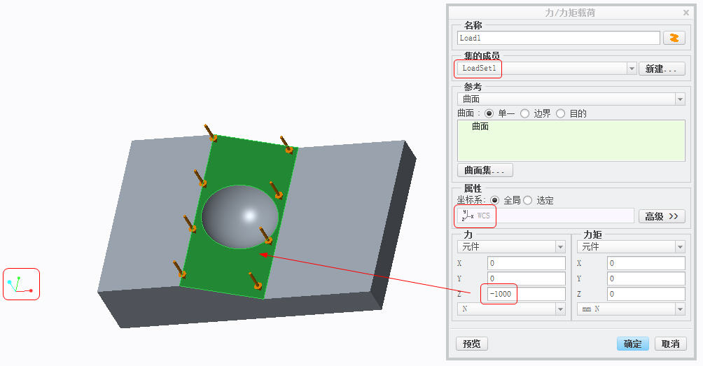

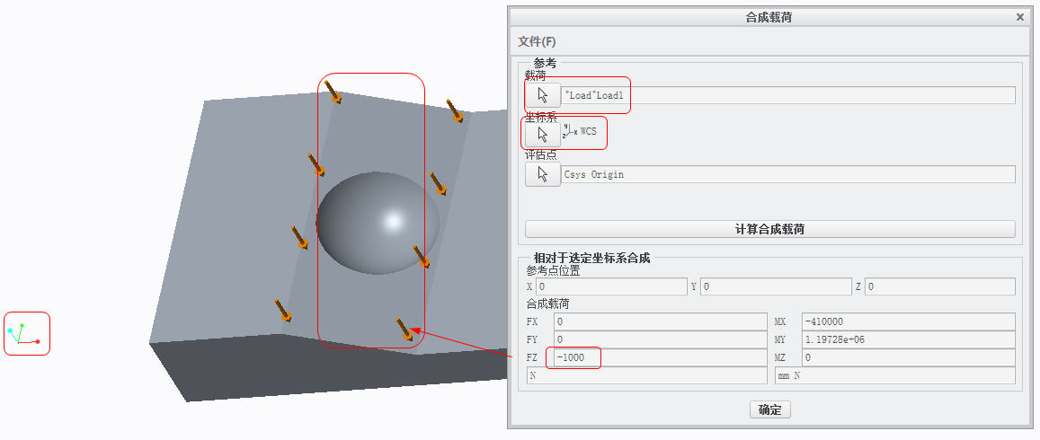

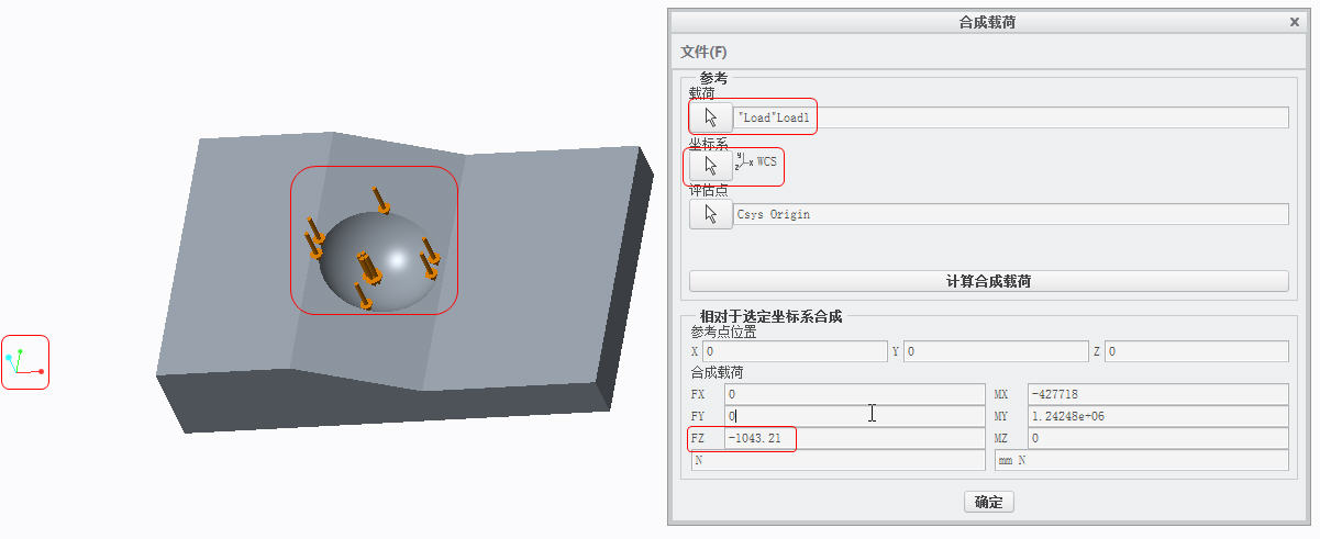

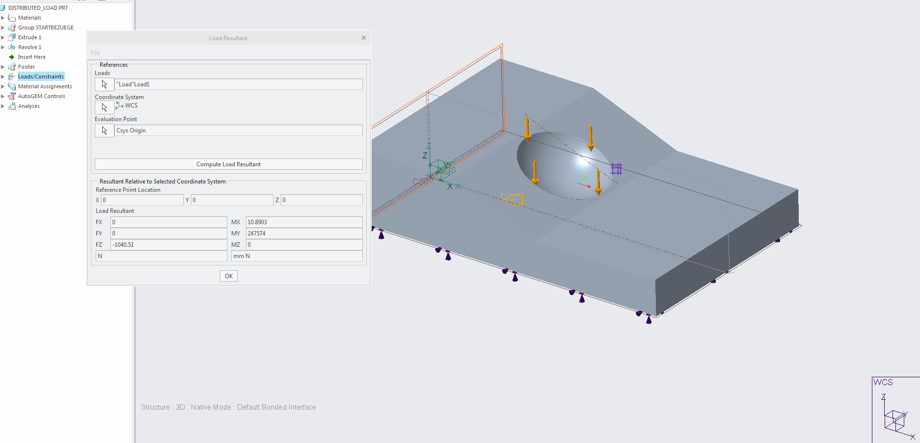

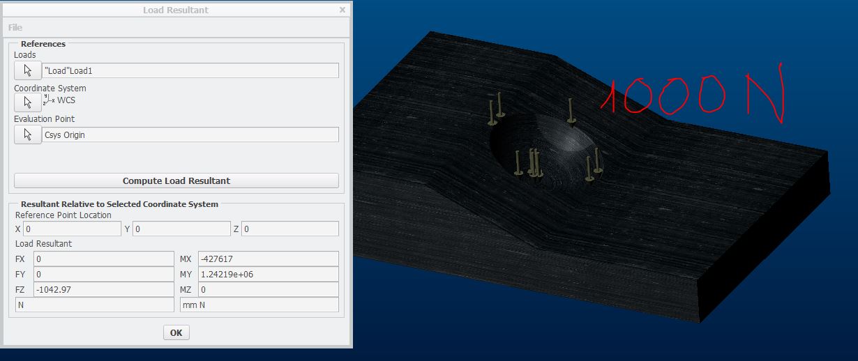

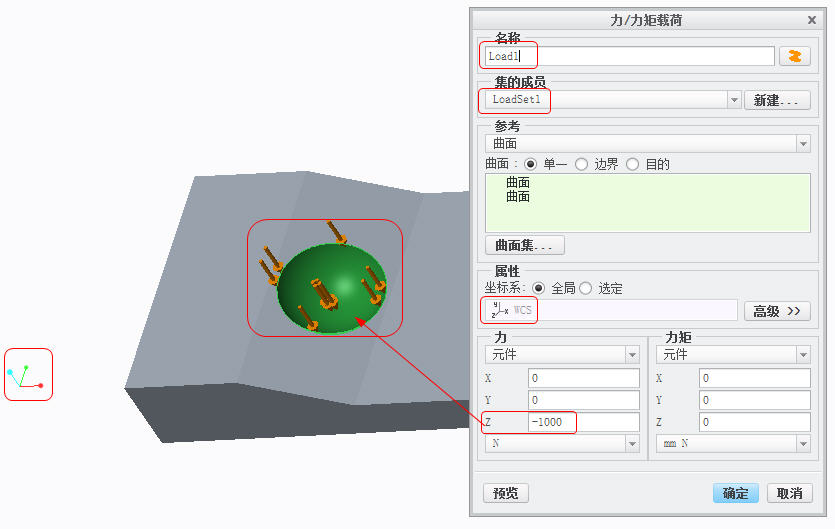

When you put a force load on the flat surface, you review total load,and the result is right; But when you put a force on the sphere surface,the result is wrong, do you all encounter this kind of problem? Attached is the images.

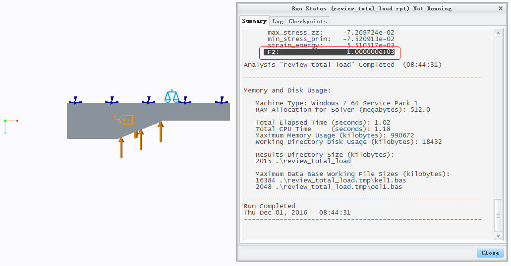

This is strange, and not good. I just ran a simple Simulate static analysis (Creo 3 M080) and the output reported -1000N as the resultant system load, just as was defined:
   Load Set: LoadSet1: LOAD_TEST
      Resultant Load on Model:
         in global X direction: -2.008443e-11
         in global Y direction:  2.360514e-11
         in global Z direction: -1.000000e+03
So, at least the analysis of the model is using the correct load value. I always check this reported value in the output file to make sure something did not go wrong. Certainly the internal "Review Total Load" tool needs to be fixed.

November 30, 2016
Test / creo simulate 2.0 m080: OK
Test / creo simulate 3.0 m110: wrong
Regards
Paul

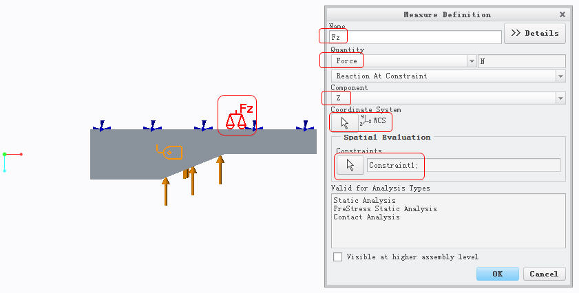

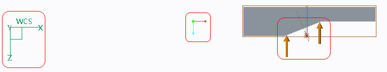

December 1, 2016

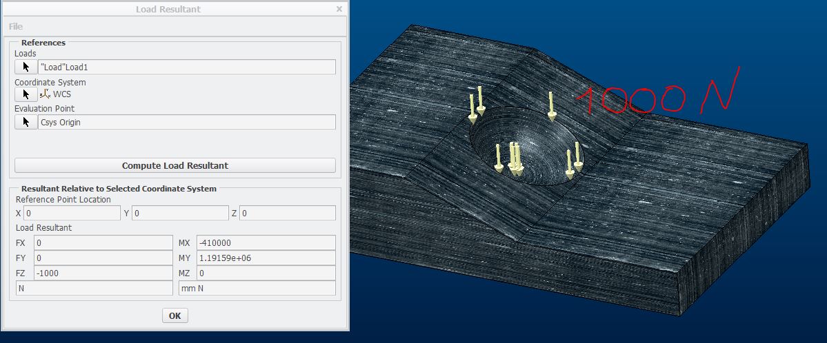

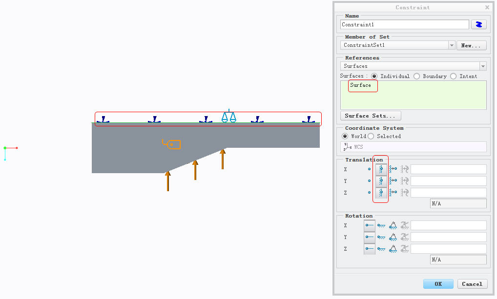

Christopher,you are right ,the internal "Review Total Load" tool needs to be fixed. I tested this several months ago.When I create a force measure of that direction,the result in the rpt file is right.That's why I still use this FEM even though this bug exists. Pasted below are some images I've made:
