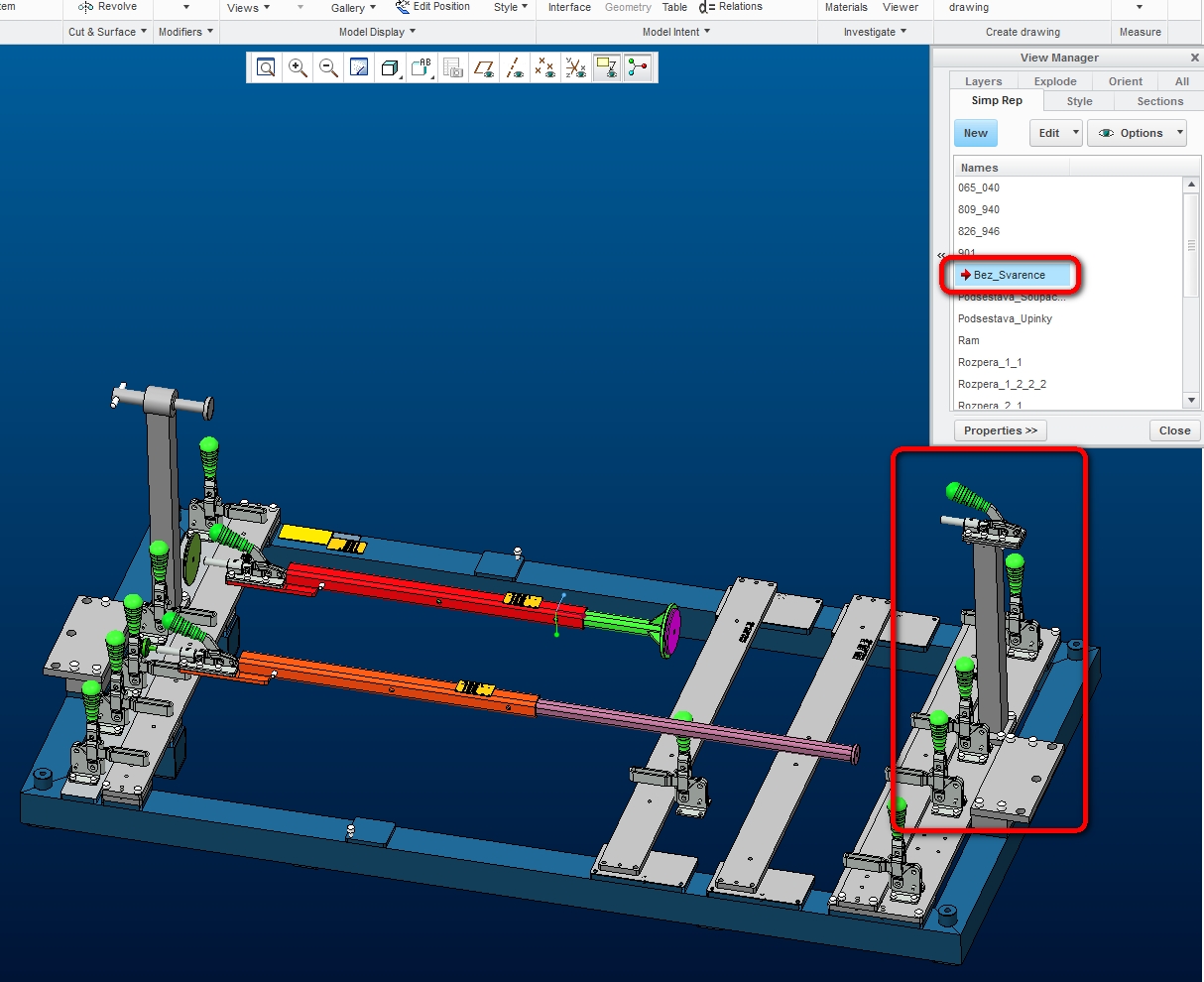

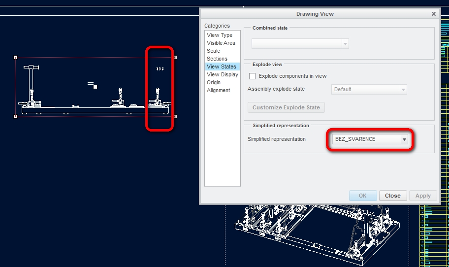

I would need to help with simplified representation view in drawing which does not match with the same one in the assembly.
I tried to redefine the simp. rep. which did not help...
Thanks for help in advance

I made a new drawing and it works fine. I will replace the sheet with a new one
thanks for help

Tomas,
create new empty drawing and put one view into it. This way you will find, whether the problem is hidden inside the assembly or inside the drawing.

Tomas,
Try changing the rep of Trimetric/isometric view and check the results. It will give an idea whether issue is due to rep or view.
