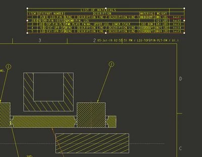

We have a BOM table that we now have a need to add another column to but this added column will be user entered text. Is this possible?
We have started to identify parts that need to be segregated when stored. We at first added a suffix to the part numbers, but when management realized that this would triple our family table sizes, they asked for an alternate solution. Since the parts themselves could in any or all of 3 states, I thought that we could add a STATE column to the BOM and then manually fill in that cell depending on the part state in that assembly.
If I cannot put the column in the BOM repeat region, my next idea is to add a single column table and place it in front of the BOM table and have the users fill in those cells as needed.

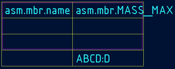

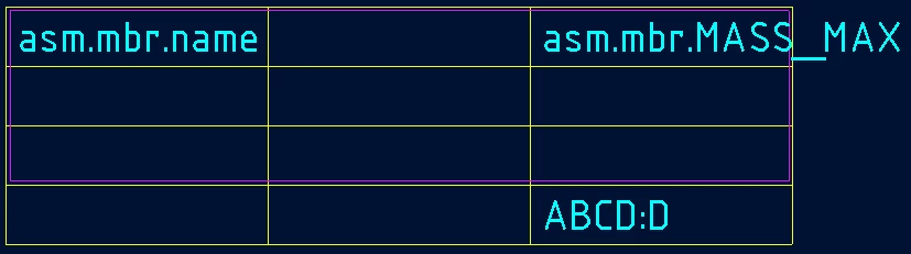

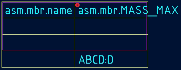

I tested "adding a column into existing repeat region"... (in Creo 2.0 M070)
I opened test drawing with existing repeat region.
I decided to add new column between two existing columns.
I clicked Add Column button and then selected location (see red circle) in top left corner of the cell containing asm.mbr.MASS_MAX parameter.
New column was added.
Conclusion:
  • if you want to add new column before existing one then click top left or bottom left corner of the cell
  • if you want to add new column after existing one then click top right or bottom right corner of the cell
July 9, 2019
Note: You cannot add new repeat region column before first column of repeat region.

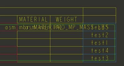

I tried the Comments command, but after adding the column, setting the cells to comment in the RR menu, It will still only allow me to edit the text in the first cell, which then gets populated to the whole column.
StephenW
July 11, 2019
I double checked when I added a column to the right side of the repeat region, set the top cell to comment, I could add text to each cell individually.
Additionally, I fixed each index to something different and the comments cell "followed" as you would hope would happen.
When I switch symbols, it shows those cells as blue, comments still appear I guess since they don't have a symbol.
July 11, 2019
Hi, I've had a similar issue and we had to recreate the repeat region.
This works for headers as well. as comment columns after. create the base table say for example 4 columns by 2 rows. So the top row will be a header row and the 4th column will be a comment column. The corners for the repeat region will be row 2 column 1 and row 2 column 3.
You can then manually add header information and comments independent of the repeat region.

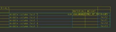

Can you define multiple repeat regions in a table? I understand what you mean by defining the repeat region as being 1 column less of the table width and this last/first column becomes the comment column but not part of the repeat region. The column we want to put the comment text into is in the middle of the table. Columns 1-3 and 5-6 are the repeat ones and column 4 is the comment one.
StephenW
July 11, 2019
I added a middle column to a repeat region.
Set that column to comments and it seemed to work just fine too.
The comment is part of the repeat region, it's only one region, if fact when you select a cell that isn't part of the region it gives you an error
***Cell has to be contained by at least one repeat region.
***Select a cell within a repeat region template.
