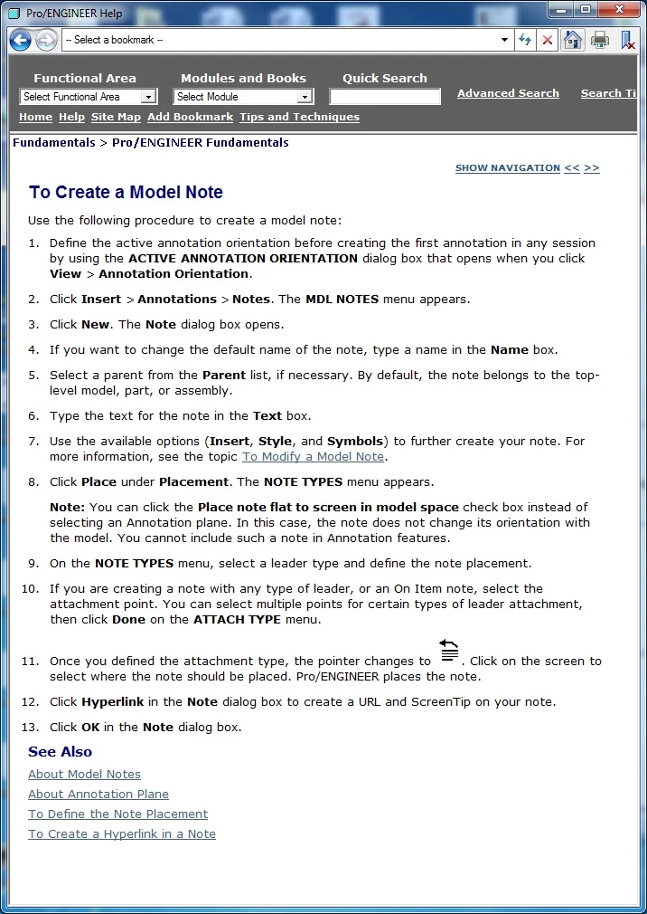

Add the note to the model -Edit/Setup/Notes/New
If you don't see it, you may need to turn 3D notes on in the Envorinment -
Tools/Environment
Note - Some features contain notes, (ie: tapped holes) which may also show up
and make a mess visually. You may need to clean up using layers once you display
the notes.
April 27, 2011
I don't have notes under edit/setup, I have model notes under insert/annotation/notes.
Steve
